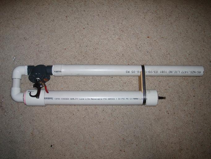

Why Phour you might ask?Well it's a spin on the golf term Fore,for when you hit a ball in some ones direction to give them some warning...And since this being a little Golfball gun Phour goes well I think.
50mm PN 12 chamber/57cm lenght.
40mm PN 12 barrel/67cm lenght.

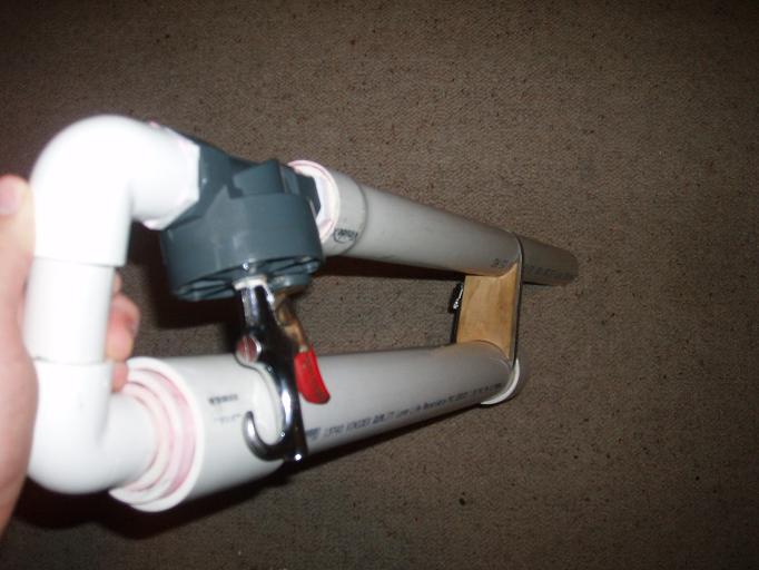

Modded Sprinkler valve.

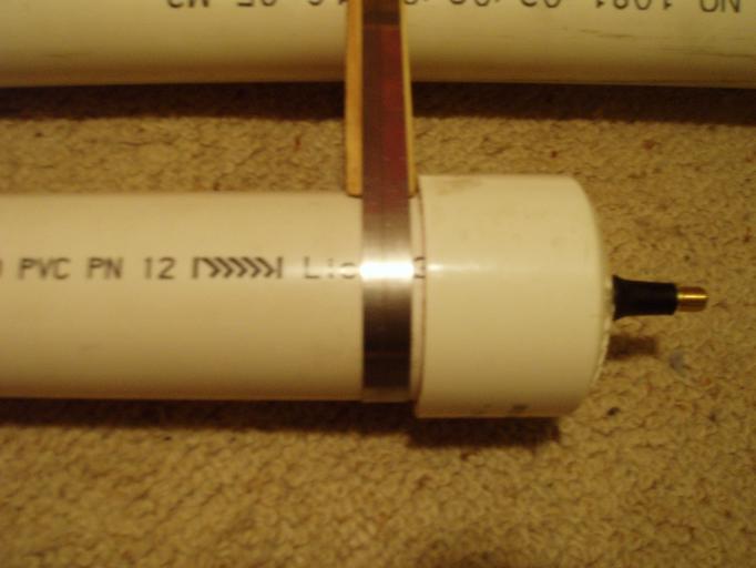

Pop in Schrader valve for filling.
86cm lenght in total.
Fun As Hell!
Average velocity of 392 FPS with foam nerf like ball at 120PSI.
This is going to be used for shooting at a friends place mainly with home made large paintballs for shooting his Tank...A.K.A his Padock basher 4X4.
There is going to be a cammo paint job on it so it doesn't stick out like dogs balls in green scrubland.
There is something about this gun,it's very sturdy.Doesn't feel like it would break easily which I LOVE in a gun.Short and Stubby how I like my Women aswell...Haha joking!Or am I?
