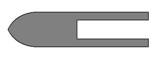

As air drag increases exponentially with velocity and you're going so fast, I doubt blunt cylindrical slugs are doing you any favours. Why not try something like the profile below? It shouldn't be too hard to turn a wooden mould for the nose section, and the rear hollow can be a simple dowel mandrel.

jackssmirkingrevenge wrote:As air drag increases exponentially with velocity and you're going so fast, I doubt blunt cylindrical slugs are doing you any favours. Why not try something like the profile below? It shouldn't be too hard to turn a wooden mould for the nose section, and the rear hollow can be a simple dowel mandrel.
Your dowel design is excellent and easy to make - I'll try it. Keeping the weight up front should reduce tumbling.

But how about keeping it together? The mass per cross section area unit is small in the center, but large at the edge (at any point of the cross section it it proportional to the front to back thickness of the projectile at the point, along the axis).
I guess than with ~10-20 bar on the breech side, the suggested profile will simply shed its tail. It's only a guess though, but really, wax breaks easily under "pull" stresses.
But maybe something like
(disregard the dots)
would work.
It's a possibility, which could be mitigated by adding some sort of disc wad behind the projectile, or filling the hollow with expanding foam.
