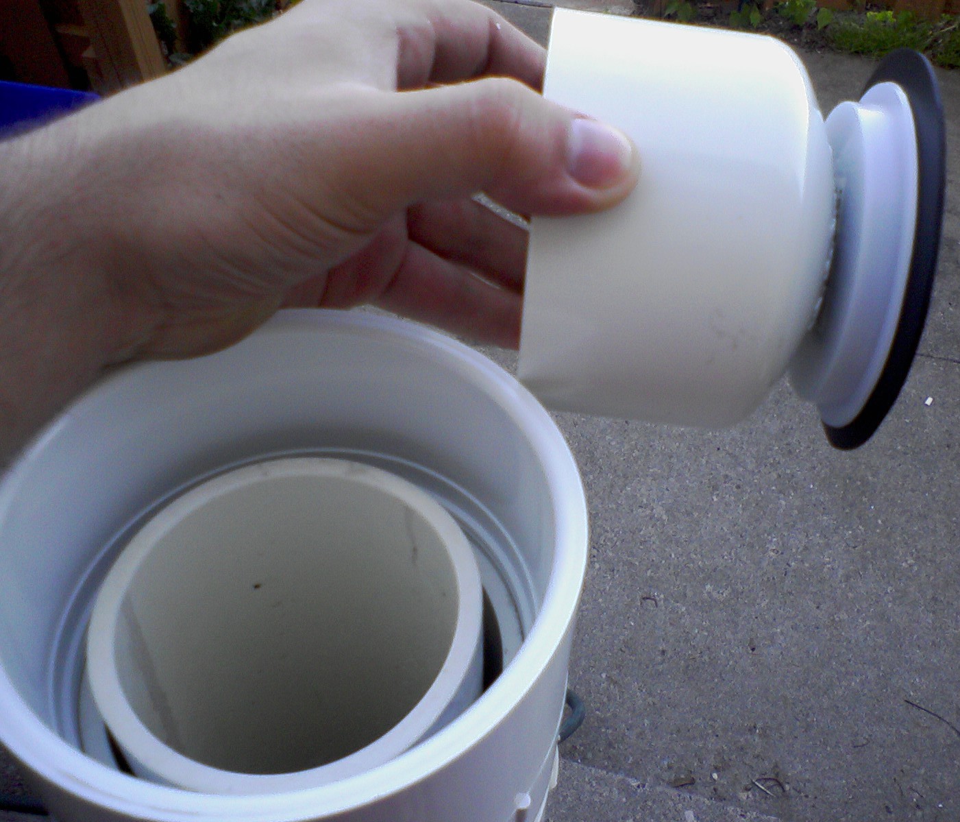

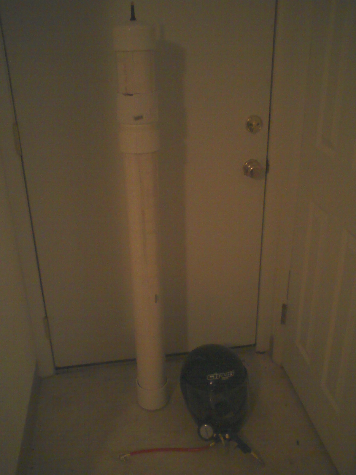

I am having a problem with my piston. When I pressurize the gun, the piston works great and holds the pressure. However when I dump air from behind the piston, the air goes backwards past the piston instead of pushing the piston back and fireing.
Anyone got a bright idea on how to seal the piston with common household supplies?

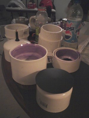

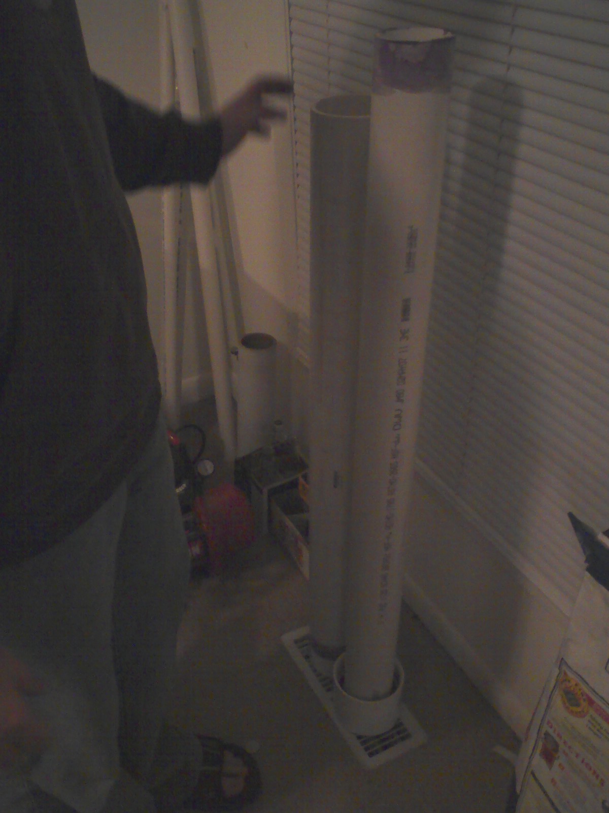

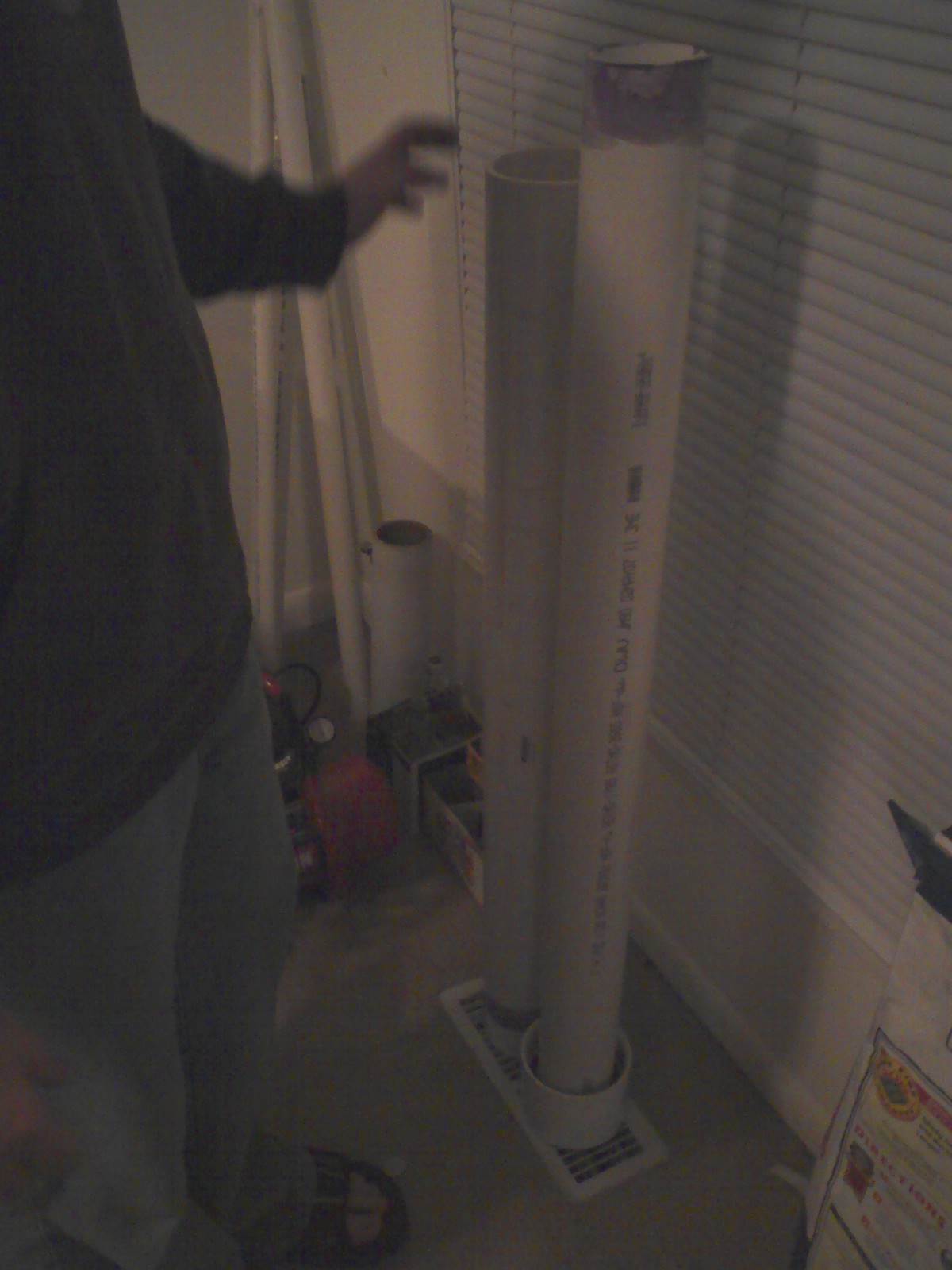

Basic design:
Body: 3" through 4" coax gun, 50" chamber 45" barrel (~150ci)

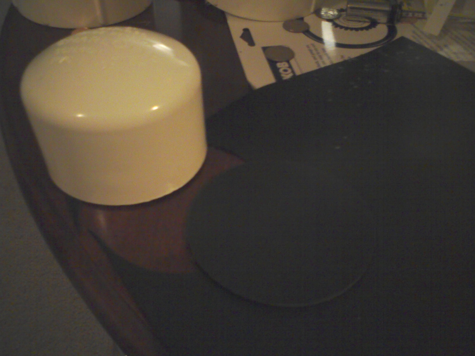

Piston: 3" endcap with neopene seal
Dump valve: 3/4" QEV (from McMaster)
My only concern is that my c:b ratio is 1:2. GGDT says I can get a 20oz bottle (600g) to about 200fps at 100psi, but has anyone had problems with the piston opening with such a small barrel to chamber footprint? (Area between barrel and chamber wall is 11.77sq in)

it will work, but as you said, it isnt going to go very far very fast. it not only the C:B ratio, but also the flow of the valve. im going to assum that its a 3'' barrel? if so then a simple ball valvewud work better than a QEV in this situation. i would say (if you are going for the most speed possible with the skills of a beginner) then say the qevand get a ball valve. it will open slower, but will have much more flow.

No, the qev will activate the 3" piston valve. (you posted before I got the pics up)

but I were you I would put a 4" tee some were in there to increase the chammber size, and I think the deaceleration due to drag will prove unimpresive

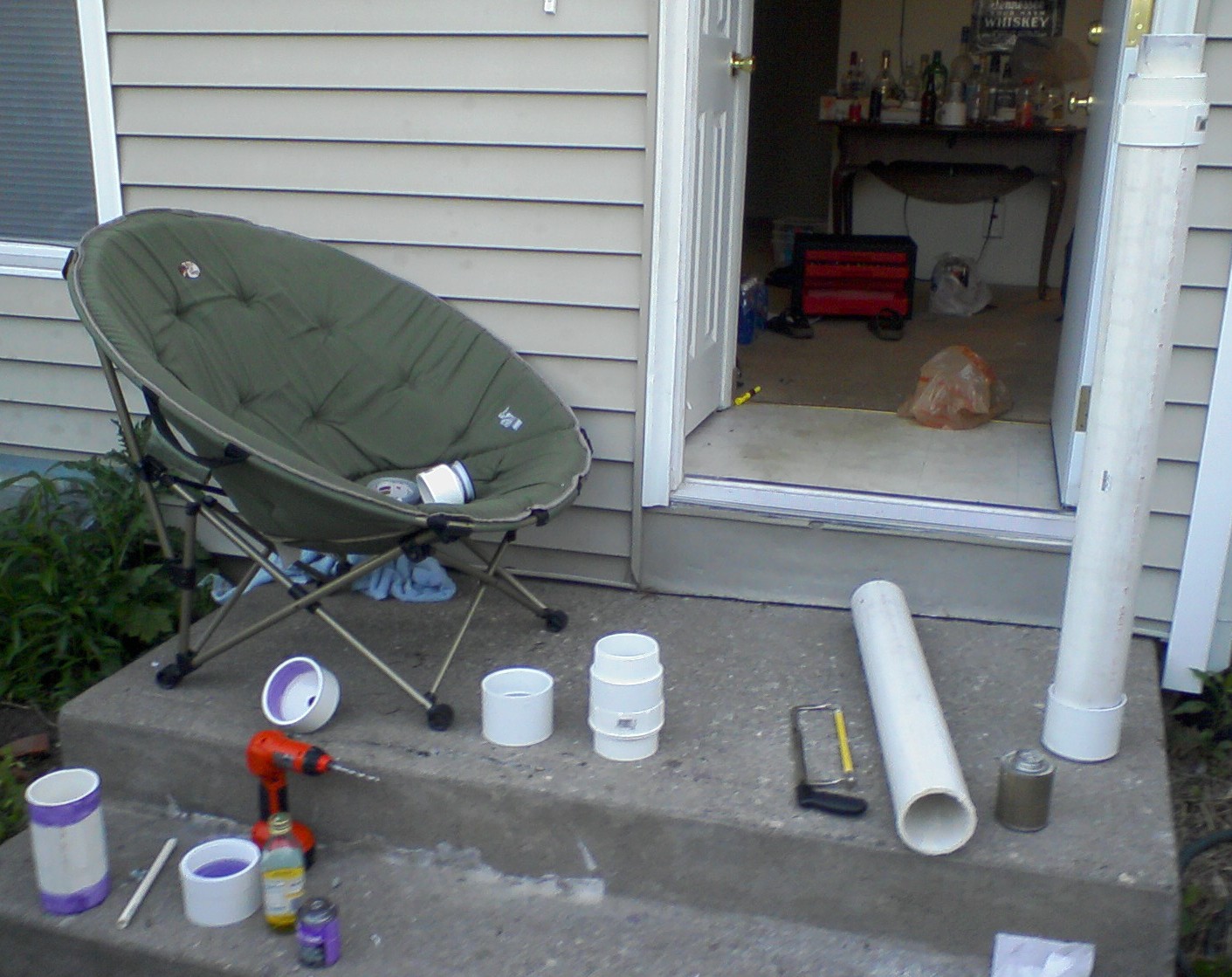

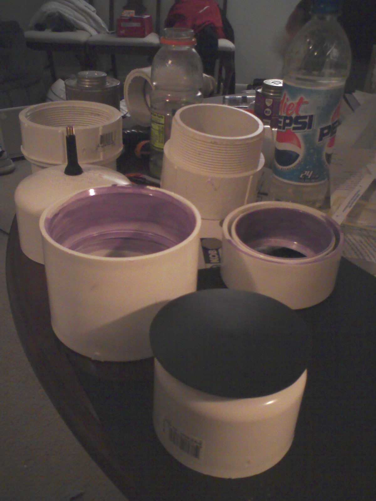

aren't you not supposed to let the primer dry completely. i like the gun though. are those all pressure rated pipes, i was looking at the price of 3'' pressure rated pvc and it was like 3.50 a foot. how much has this project cost
Do not glue those fittings together yet! First, add a fresh layer of wet PVC primer, and then immediately put the glue onto the still-wet primer layer. Then twist them together, hold for thirty seconds, and you are good. PVC primer should not be used when dry. Its purpose is to soften up the PVC pipe, and if it dries, it has no purpose.

Oh well I guess I learned something today, dry primer = bad.
It's cost around $100 probably a little more, all the pipe is pressure rated (gimme a little credit huh?) The worst part was buying 10' of 4" pipe cause lowes doesn't let you buy it by the foot.
Oh, I had the 3" pipe left over from an earlier build.

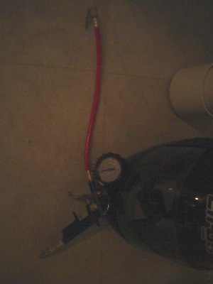

I just pressure tested it to 100psi, no leaks. I was worried about the threaded coupling, but teflon tape rocks!
Unfortunately I can't get anywhere neer enough flow to fire it, and I'm going to have to try wraping my piston (duct tape probably) to get a better seal for fireing. The neoprine held against the barrel and that's whats important.

Very nice. It looks good. I can't wait to see it with the QEV. Are you going to paint it?

If you do wrap your piston in tape, make sure to lubricate it. Duct tape doesn't slide on the inside of PVC very well. But it does with some liquid teflon or lithium grease.GinsuGuy585 wrote:I'm going to have to try wraping my piston (duct tape probably) to get a better seal for fireing. The neoprine held against the barrel and that's whats important.

hi: Technically I still don't know if it will work
The small chamber cross section doesn't have a good ratio to the rear (vent) cross section, so I will have to dump the air furiously to make the piston move. (QEV Power!)
Pete: I've been using veggie oil so far (great for the neoprine) it might work with the duct tape too, but will probably get real nasty after a few weeks. I've been debating graphite vs. lithium because graphite is alot easier to get, but may adversely effect the piston's seal with the barrel.
Also since the piston and rear valve assy. is threaded, I can make more barrel/chambers as long as I add male threads. (and have alot of teflon tape on hand)

instead of duct tape you can use that stretch and seal plumber's tape used for leaky pipe, it's like rubber tape

and why is dry primer so bad? just ad a new layer right?

I'm thinking mold/bacteria growth. As per the dry primer, I was glueing after the primer dried. Won't adversely effect the joints per se but it's not optimal.
