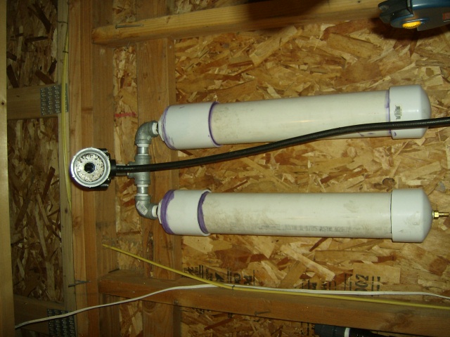

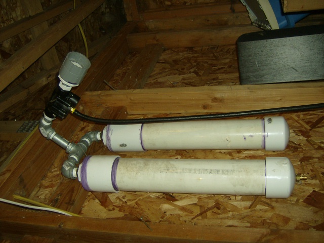

My first attempt at air
Let me know what you think...
I use it at 110 psi and it rocks...
My first Pneumatic

I'm guessing you're missing a barrel in these photos? And judging by the launch angle, this seems to be made for lobbing substantial objects over relatively larget distances...

It looks like you used all NSF-PW fittings (right?) so nice job there.
Two small complaints:
There's a lot of restriction and dead space between the chambers and valve. Using larger diameter pipe for the elbows and T leading to the valve, or less length of it, would open up the airflow a lot.
You don't have a pressure gauge. I think a pressure gauge is a requirement for any pneumatic (otherwise you can't tell when its charged or not without firing it). If not, at the very least, a safety pop-off valve so the chamber can't be overfilled would be a good idea.
Nice job on the modded sprinkler valve and overall design. Looks like you did your research. Overall, great job for a first pneumatic.

Considering the restriction caused by the tiny valve relative to the barrel, I doubt this alone would improve matters unless the valve was upgraded.Pete Zaria wrote: There's a lot of restriction and dead space between the chambers and valve. Using larger diameter pipe for the elbows and T leading to the valve, or less length of it, would open up the airflow a lot.
I've never had a gauge of any of my launchers - if in doubt, you can always hook it up to whatever you used for filling (pump, compressor attachment etc.) and check the pressure on the instrument's gauge. The only exception would be if you're using a gaugeless pump like most compact bike pumps.You don't have a pressure gauge. I think a pressure gauge is a requirement for any pneumatic (otherwise you can't tell when its charged or not without firing it). If not, at the very least, a safety pop-off valve so the chamber can't be overfilled would be a good idea.

@jackssmirkingrevenge,
OK, you're probably right. I doubt the 1" pipe constricts the flow any more than the valve does, but if you ever upgraded the valve, this would become the bottleneck. Also, bigger elbows and Ts can never really hurt.... heh....
I still think a pressure gauge is a good idea. It aids in filling (more consistent, allows you to know how much air you've put in) and also lets you know if the gun is charged or not at any given time. Unless you're ONLY going to use the gun with a compressor that has a gauge, I'd suggest one.

It has a few barrels i have the trusty 2in by 5ft for potatos and a 4 in by 2 ft for tp. I originaly made this for toilet paper launcher so wsnt looking for range but i was supprised it blows a pot around 150 to 200 yards....i put one through a 1/2 in ply last week and thats at 110 psi. It is fully adjustable from straight up to straight forward. My chambers are 3in by 3ft, i didnt know much about cannons when i put it together and used 3/4 in piping...wnt be that for long.i want to make a piston but i dont understand it yet so i will research more b4.It is all nsf-pw and i use it with a compressor thathas an air reg. on it, only ever set to 110 max. i am going to install pop off , Like the thread says it is my 1st air launcher , but good looking out.
