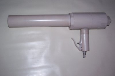

this is my first .177 cal cloud. used bb gun rifle barrel. it shot fairly good but i have decided to build a inline vortex block for it out of aluminum. i wanted the gun to resemble a mac 10 but i havent made sights for it yet.

That's a cool looking gun, but what did you use for the barrel?

i took apart a broke bb gun rifle and used the barrel from it.

I know your planning on makng a vortex block, but an easy way to increase ROF and power would be to make the chamber smaller. I use 1.25" for all my chambers, except for my most recent cloud, which uses a longer 1" SDR 21 chamber.

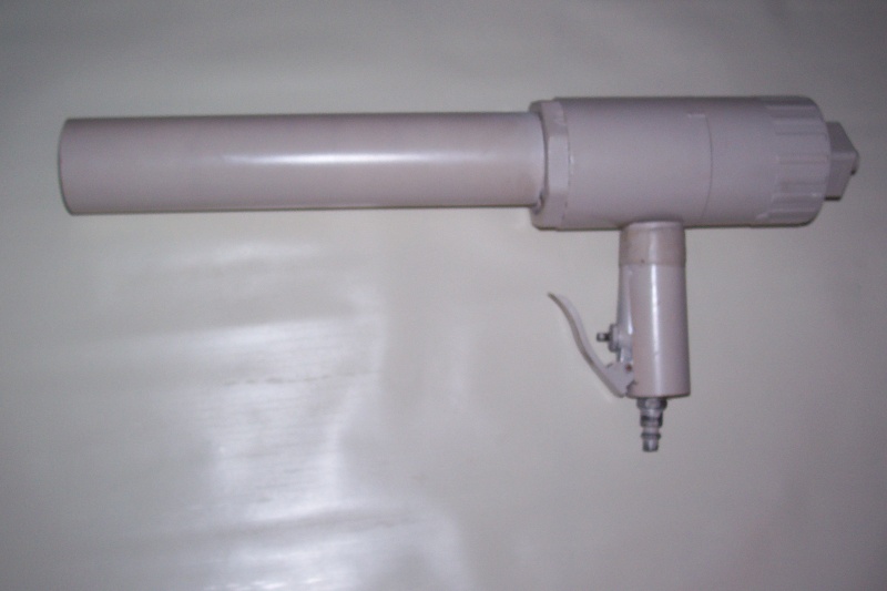

veginator i was going to use 1" sch40 but i dunno how long that would last, maybe instead i would use aluminum cause i can melt and cast aluminum into just about anything, (backyard foundry) a square block would not be hard to cast and machine.

Spuddin, PVC will last a long time. There's no need to waste aluminum.

You're using 1" Sch 40 for a vortex block? How would that work out? Or were you going to use my "ghetto block" idea?
And so you know, aluminum is definitely overkill. Acrylic and PVC are close in durability, and after a year or so of both, I haven't had a block wear out, even with steel BBs. Aluminum is also extremely hard to work with when you need the precision necessary for a good vortex block.
