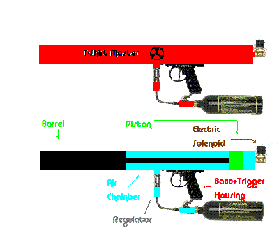

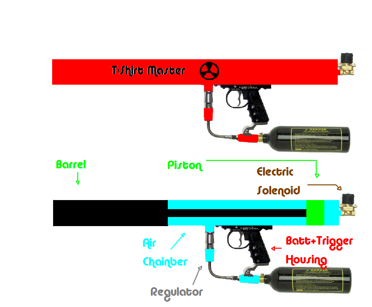

I built a couple of tshirt guns for high schools and I think that it is time for me to take it to the next level. I came up with this idea, it is very simple and durable. I plan on running it around 200psi. The main body will be constructed from 2" exaust tubing (because i can only weld steel no TIG welder) and will have a paintball co2 tank, regulator, and trigger frame to house the batterys and switch for the electric solenoid valve to accuate the piston. I think I will use a smaller peice of pipe plugged at both ends as my piston in an effort to keep it light.
Please give me as much critisism and suggestion as possible! I am very interested in your comments.
I am planning on selling it for around $300-$400U.S.
T Shirt shooter Idea

So do high schools ask you to make them t-shirt guns or do you offer to do it? Just wondering and sorry about hijacking your thread.
Your design looks really good. How long would it take to reload?

Looks very nice, but I would put a ball valve between the exhaust valve and the piston, as a safety.

kinda seesm like you got desighn form here. http://tshirtgun.com/

Id say go for it mate. Its a nice design and looks like she'll have some power if you dont want a T-shirt in the barrel

you have 1 tiny problem..ur design shows filling from infront of the piston..now im not an expert on co-axials and i think you can put a spring behind the piston so it holds it there while you fill.. and then u have to have an equilization hole so the air can get through...well ill help u in a little bit i have to go get a shower now..
oh and can you tell me your specs of the gun? like the pipe that the piston seals on..and diameter barrel..are you sure u r going to need 200 psi? well...maybe since the tube the piston is sealing on is small..good luck!

Looks like one of the commercial T-Shirt cannons I have seen on other websites. I would also build it out of metal and include a pop safety valve to keep all the Commie-Libs from sueing you. I would normally make it myself, but if I was someone else in charge of an event involving slinging T-Shirts, I would buy it. Make sure you got some liability insurance before you start to sell them.

Sorry about not getting back to you guys very soon, Ive been busy. Well to start off, thank you very much for the comments, I will take them to heart.
@ Flying_salt, yes, the origanal school asked me because a kid mentioned my spud gun adventures. After t6hat I decided to pich the ideas to other schools.
@insomniac, I have an electronic safty switch in the trigger frame that looks a little more professional.
@pyromaniac, yes this was my overall insperation for THIS gun, however I have improved apon the design (i think) by making it more astheticly pleasing and simpler.

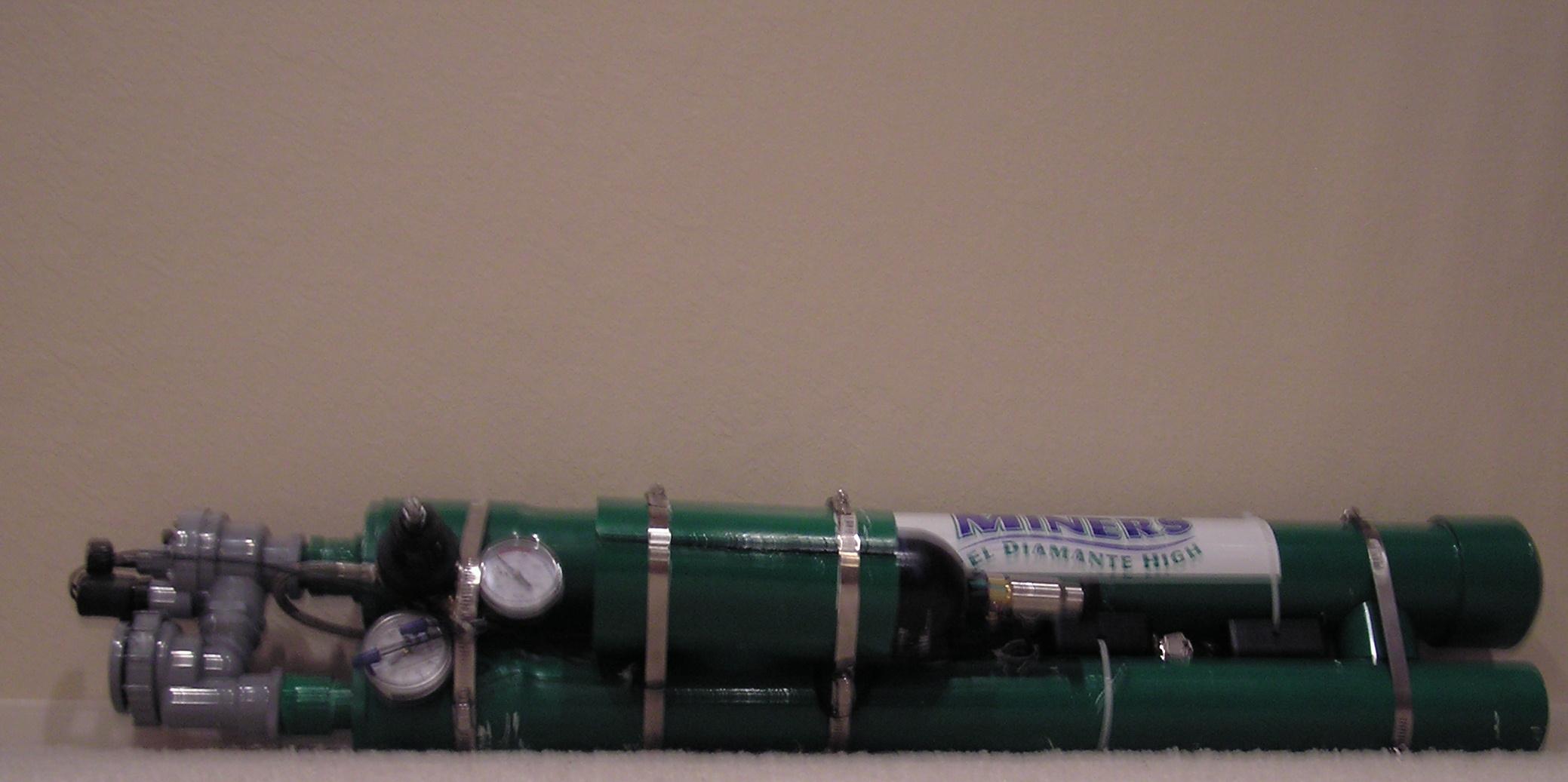

Also, I have sold these launchers to other schools:
@spudthug, you are very correct, I forgot to put in the braided steel line (in the paint picture) going to the back of the gun. Also, the valve in the back I have decided will be covered.
