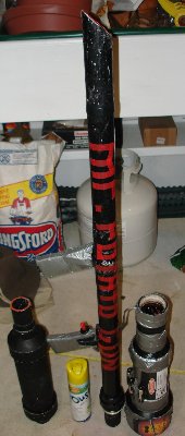

You can pretty much see every thing in the pics, so feel free to skip the description.

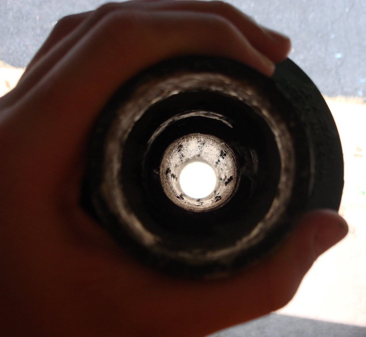

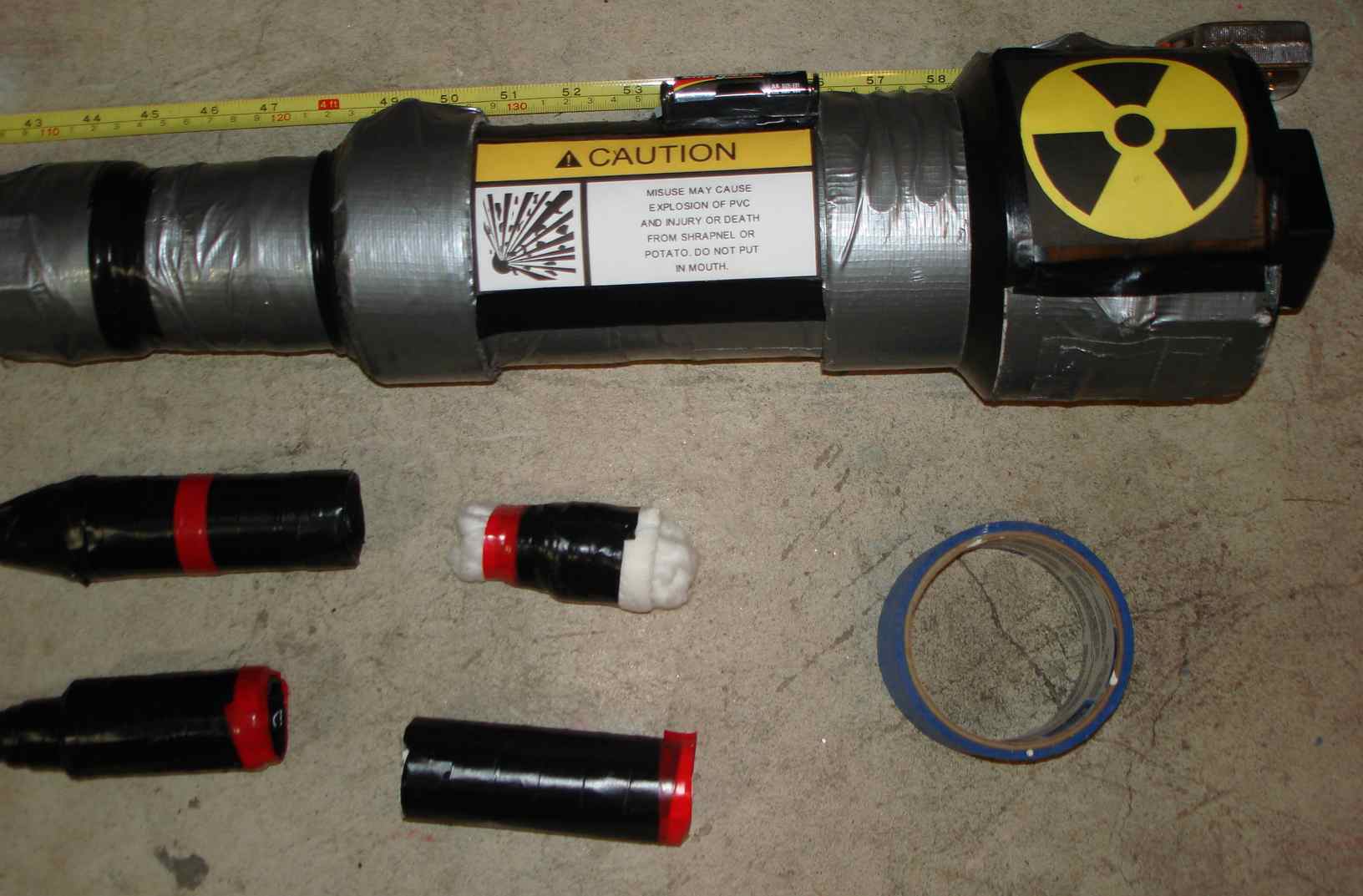

Without the silencer, the C:B ratio is about 1.25 to 1, with it is about 1 to 1. The barrel is 43'' in length, made of 1.5'' PVC, but it has holes for the silencer for the last 5''. These can be covered or uncovered by preference.

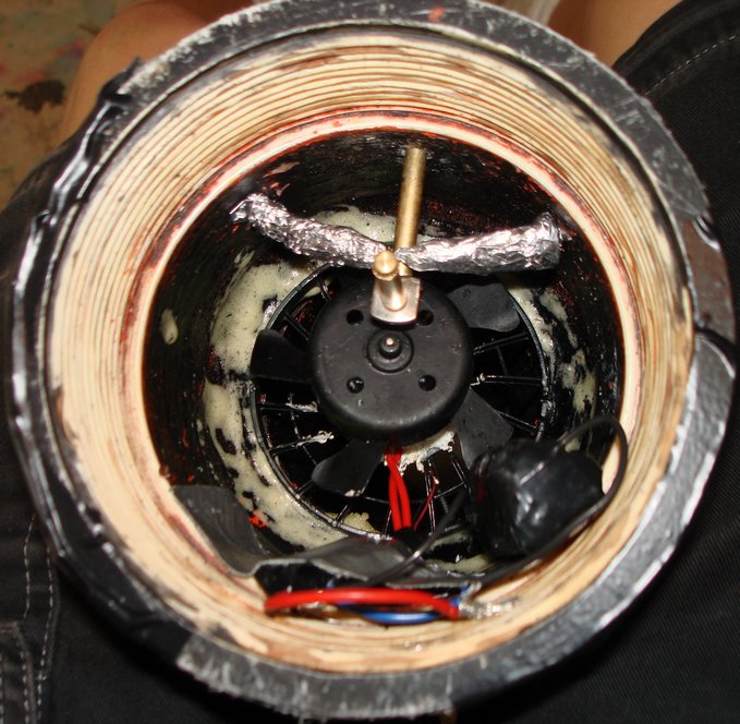

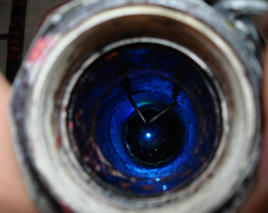

The chamber is made of 2'' of 2'' sch 40 PVC, 9'' of 3'' PVC, and 3.5'' of 4 PVC. However, the fan and batteries take up a small amount of space inside the 4'' PVC. Inside, I used a dual ignition setup, with one contact at the front and the other at the back, both powered by a grill clicker. In the back section, I also threaded a removable lantern lighter (see pic) between the contact, making 2 sparks instead of one. However, when the lighter is in, it results in a small leak.

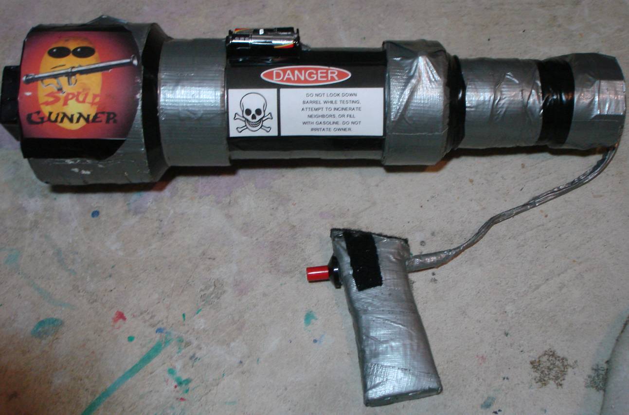

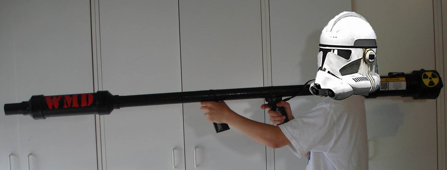

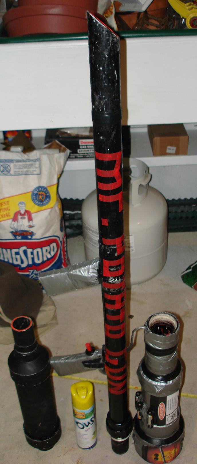

Now, for the extra features... As I already said, I put a cheap fan in the chamber, along with a color-changing LED (Just for looks, of course) with a battery pack for it. The fan's battery pack is external. I made the barrel breach loading, but because I am cheap, it is a screw-in. However, loading is still much faster. Also, I attached two handles to the barrel for a comfortable grip. The silencer, one of the cooler accessories, is made from the left-over length of the chamber and barrel - 1.5'' surrounded by 3'' PVC. The inner barrel had holes cut in it, and the outer is packed with cotton. The assembly slides about 5'' onto the barrel, making the whole gun a hefty 6' 2''! I painted the barrel black, added a glaze, and covered the chamber in duct tape. I also added some semi-corny labels and pics that I made in flash pro and online.
UPDATE- To make the gun look more "professional", I repainted the whole gun a cool glossy black. I covered the handles and chamber in electrical tape for looks, durability, and insulation. I renamed the gun the WMD - Weapon of Mashed Destruction. Sorry if that has been used, but hey, it sounds cool. I also cleaned up and rewired the chamber, resulting in a much larger spark and a more reliable fan and light.

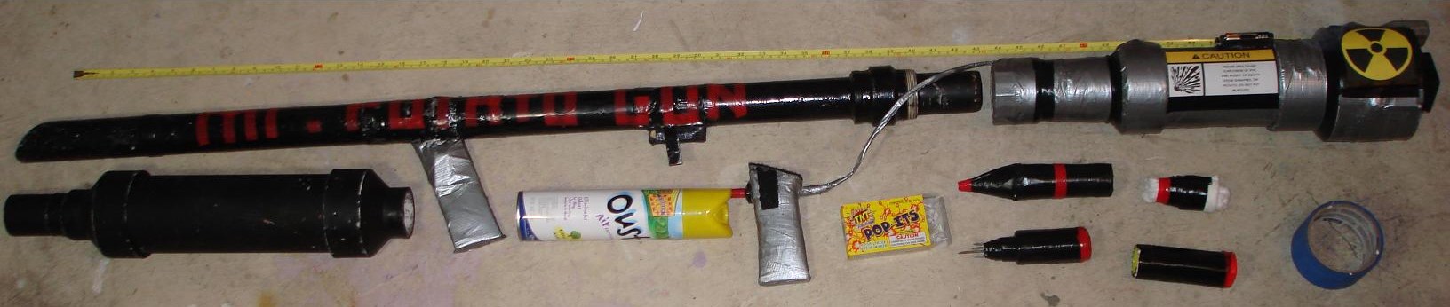

UPDATE - Here are some new pics of the less ghetto launcher. Check out that 360!! As far as I know, that's a first on the boards!

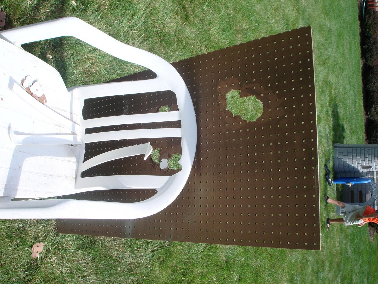

UPDATE x 2 Hey people, I finally posted the damage pics! also, here are two videos:
http://video.google.com/videoplay?docid ... 4279&hl=en - This one shows the gun shooting a spud at a board. The laughter in the video- not me. Funny in slow-mo.
http://video.google.com/videoplay?docid ... 3614498301 - This one shows the potato penatrating a 1/6'' board and the chair behind it! I found pieces of the chair 30' away!
