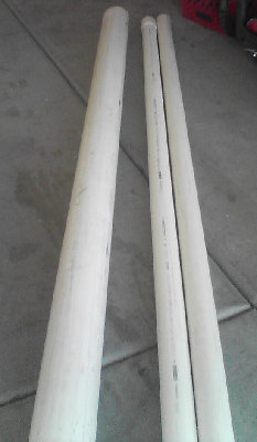

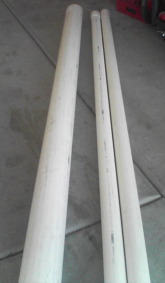

Im trying to clean some stains off the pvc I just bought and was wondering, other than painting, what is the best way to make your pipe and fittings nice? I've tried some scotch-brite sponges and the hose but have really done nothing. I was thinking of trying maybe some lacquer thinner or some denatured alcohol. What have you guys used?

go to the home depot or lowes near you house and go look near the PVC glue, there should be a yellow can that is labeled PVC Cleaner, that works really well, i use it to remove the print from the pipe for a clean white look. If its scuffs your trying to remove try putting the cleaner on the spot then rubbing it off with a tennisball.

Get a can of carberatur cleaner. Just spray a little on a paper towel and use that to clean the PVC. Personally, I like Gunk brand, but any will do. It has acetone and MEK in it, which will remove the lettering on the PVC but not damage or take away the glossy finish.

I use denatured alcohol. It generally takes off surface blemishes, but you will have to take out scuff marks with fine steel wool. I generally use the steel wool by itself, no prior sanding.

i have some carb cleaner, and some denatured alcohol around the garage. ill give them a try this afternoon when it cools down. i just dont want it eat away at my pipe
