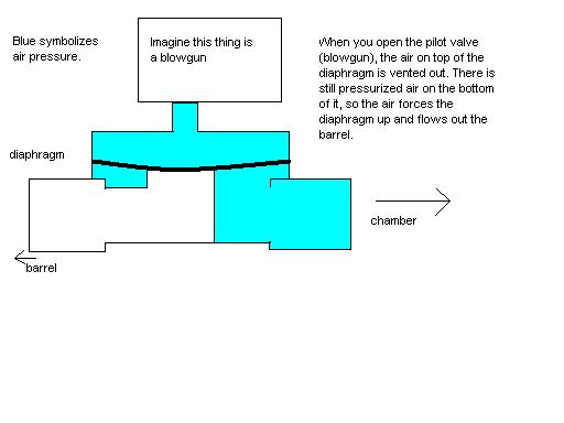

noname
Posts: 2698
Location: Bay Area, CA
I'm surprised no one posted a diagram.
Here ya go!
Here ya go!
