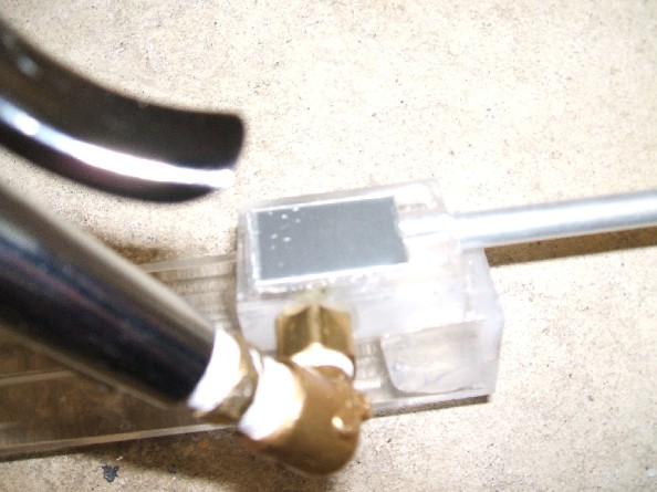

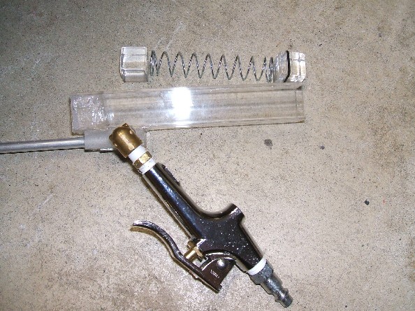

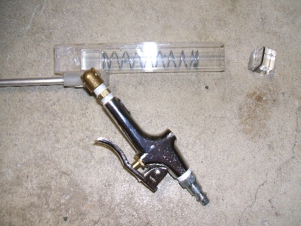

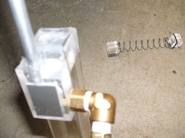

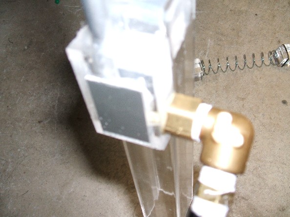

This thing is simply amazing. It empties itself in about 2 seconds (~250 rounds). The concept for this gun is totally new, as you may have seen from my sig. The body is square acrylic tubing (sweet!) and the vortex block is flat on it's side, below the gun. This is the second "full hole" vortex block I've made, because a partial hole wouldnh't work well for this gun. The bottom of the vortex hole is covered with aluminum sheet. The front is plugged with an acrylic cube. Another acrylic cube (thanks Modder) is the plunger, while another acrylic cube, with an O-ring on it, serves as the back plug. The O-ring doesn't completely seal the back, but the gun still shoots better than any other strafer I've ever made (keep in mind, that's 8 or 9). The blowgun is attached to the vortex block by a compression elbow, a tiny piece of 1/4" brakeline, and a drop of epoxy.
The BBs are blasted out of the block as fast as the plunger can push them in, which is, as you can imagine, extremely fast.
Now, feast your eyes!
Edit: Sorry for the crappy pics.
The SideStrafer
