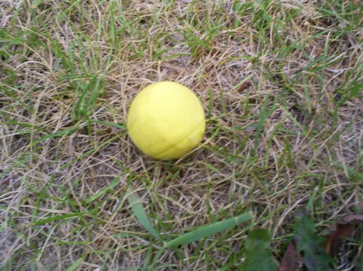

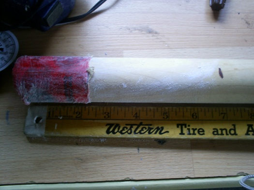

I needed something to shoot (and some ammo), and I found 2 sheets of 5/8" MDF, which I nailed together with spacers to created a 2" gap in between. For ammo, I used a 300 gram piece of wooden dowel that was 16" long, with no modification except tape to help it fit better. GGDT said that this should achieve about 330fps and 1130 ft/lbs of muzzle energy. For wadding I used a ball abou 1 3/4" in diameter made of a foam like material which sealed the barrel very well.

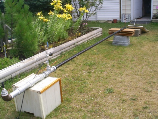

The SCTBDC with 12' barrel attached after being replaced on stand after firing.
The dowel that I fired. This picture only shows the 6 1/2" that penetrated the wall
The foam ball that was used as wadding.

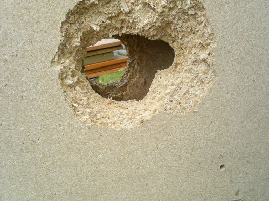

Hole in front of target after the shot.
View of the target from the back after the shot.

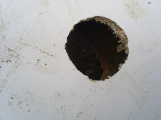

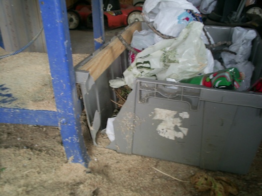

Garbage bin that was ripped open from dowel on its way through the shed.

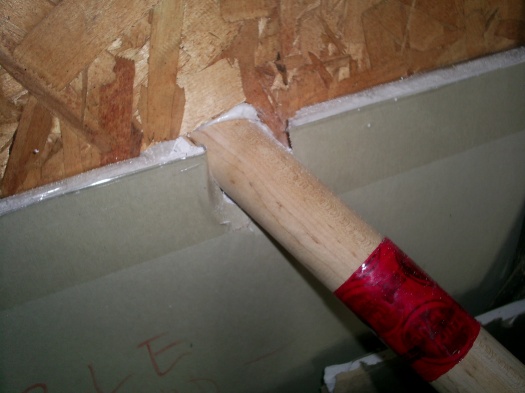

The dowel where I found it, before being moved, embedded 6 1/2" into a wall in the back of my shed. It had spun 180 degrees before hitting the wall.

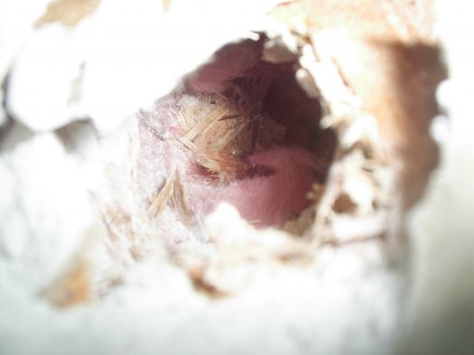

The hole in the wall where the dowel penetrated.

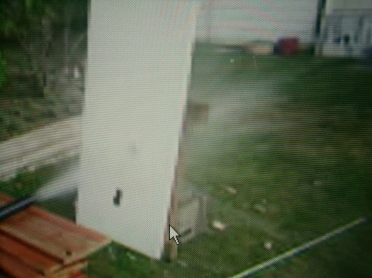

The moment when the ice slug hit the target.

THat is a great gun.I take it the abnormally long barrel is for higher velocity.

@potatoflinger: it is more than thirty feet from the muzzle to the wall, and it became embedded in the wall after being knocked off course from penetrating the tub

The C:B ratio with this barrel is about .25:1, and it allows a large amount of the available power to be transferred to the ammo. It is kind of awkward though.
