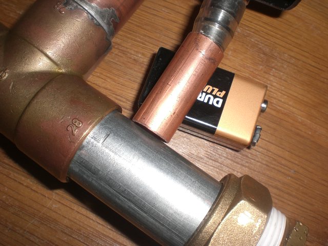

ok since a few weeks having no time to build further I got some time and I still have some problems
I want to solder a piece of pipe to the side of a bigger pipe will this work ?
I have got the valve but still need to make a piston.
I have got the adater for the barrel and only have to solder that(that won't give problems)
here are some pics
battery is to hold it in place
valve and pipe are connected by tube
here are some pics
Good luck with your piston, In my opinion you should have made the valve first. But hopefuly you will get lucky.

Woah, why do you have so many different metals together??

That connection of the blowgun will give you a lot of trouble.
It would be better to connect it from that endcap and curve it back up.

I thougt it would be better to make a small pipe into the pipe that comes from the chamber so the piston is bigger than the pipe so it seals better
and from cap to valve sounds better but the only problem is how to pump it then?

just all the things you see in the pictures and soldering stuff.
but do you think it's better to make the smaller pipe in the pipe that comes from the stock/chamber?

I mean the pipe that is showed above with: /
for my idea
.___ _______
......\/ _|____| I hope you reconise the gun
for my idea
ignore the dots
