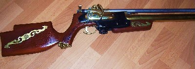

" Old Shatterhand" 5 shot mag now cycling on vid.

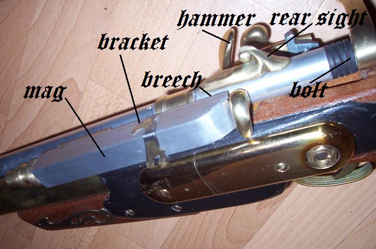

Impressive. Is there anything installed to prevent multiple feeds or does it just seem to work?

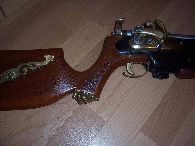

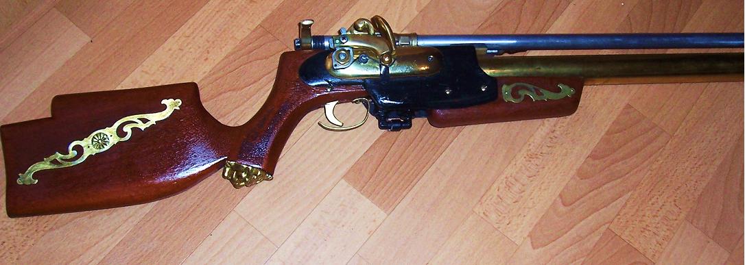

I've added the retainers for the mag, wich not only look the part, but also keep it in place rock solid.
It's still removable.Just slides off after a good push.

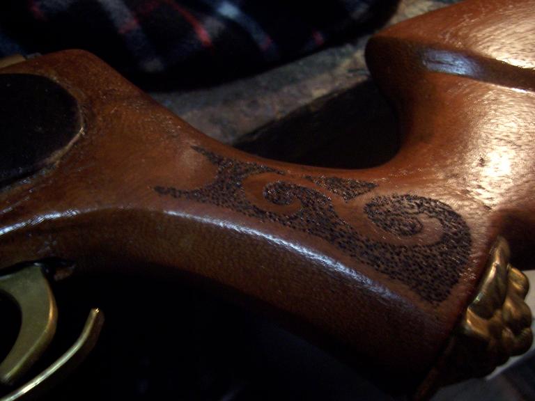

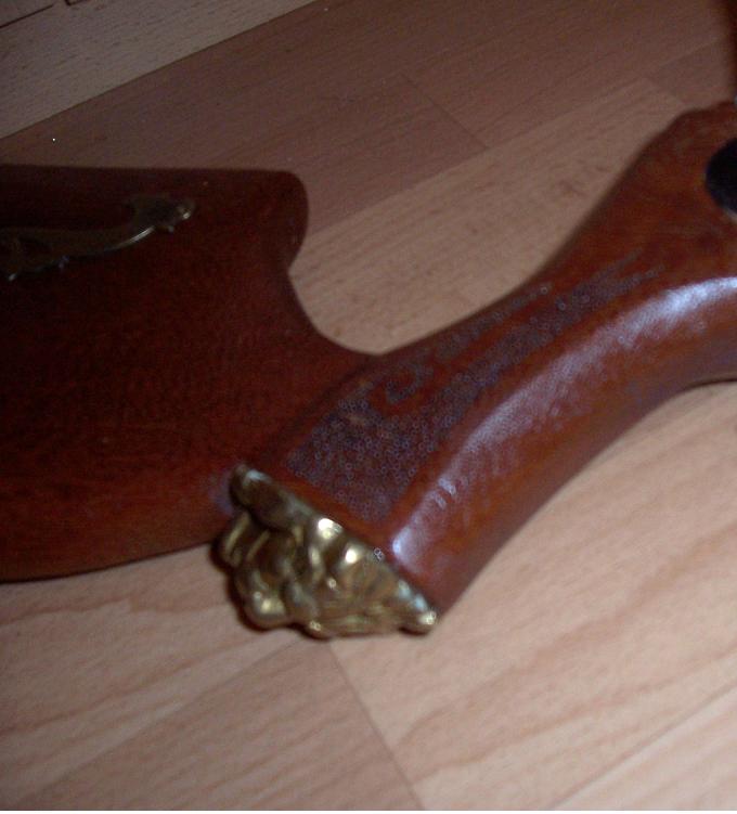

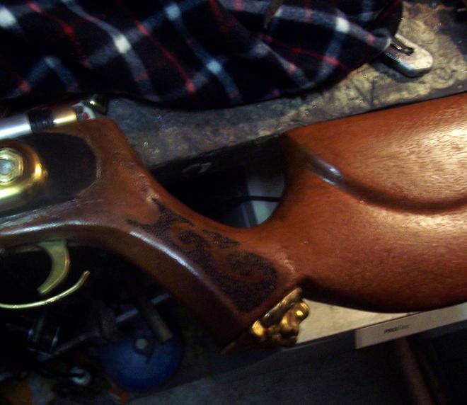

I've just started checkering bits of the stock...
It will look amazing!
I use a centerpunch ( ?) and a hammer and do it like they used to make tattoos.
Samoa style baby!!
I'll add some curles and stuff to make it look 1800's..
It will need another coat of laqcuer afterwards..

The BB is pushed back against the bolt by the next BB in the mag.
It is only freed from this position when the bolt slides forward.
I can however get a double feed if I deliberately work the bolt twice..
If I would do it 5 times I get buckshot..
Samoa style baby!!

Yes.The T-bolt design means the bolt is the same diameter as the ammo.Impressive. Is there anything installed to prevent multiple feeds or does it just seem to work?

Ask MrC for advice
I remember seeing an article on an airgun magazine recommending a similar technique to texture a stock, simple and with a bit of patience the effect is impressive
A problem with most mag fed PCPs, it's only a major issue when you have a suppressor though as you can easily damage the baffles - as I did with my MonsoonI can however get a double feed if I deliberately work the bolt twice.
Cool!
How long did it take to make thousands of dents?

@ Psy: About an hour.But I'm not sure..
I started on it today and posted about it two days ago.
It was finished yesterday..All this timebending got me confused..
Yeah..I'd say about an hour.

The problem is the guy working the bolt twice..A problem with most mag fed PCPs

In my case it's assuming that the Monsoon failed to cycle, then cycling it manually, and there you have it, 2 pellets in the breech. With bolt actions it's easy to automatically reload after shooting, then thanks to a delay/distraction until you take your next shot you reload again before shooting.Brian the brain wrote:The problem is the guy working the bolt twice...

Still the problem is the guy working the bolt twice.

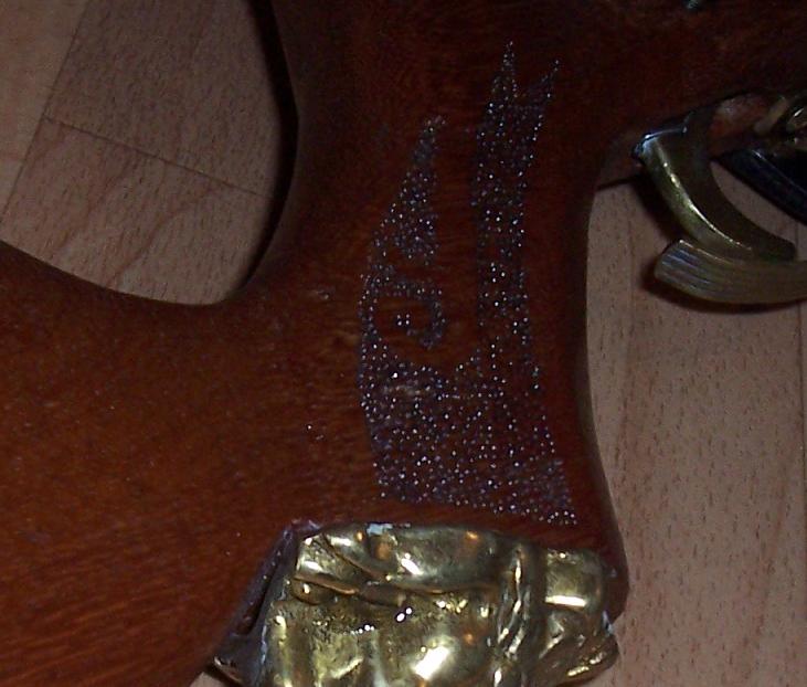

I made a small vid of it cycling...ONCE..
<a href="">hope you like it!</a>
And some pics of the checkering on the opposite side now.
I used ink to fill up the holes, sanded away the ink on the highs, then lacquered it again..
result:
( yes this is with the focus on)
Oh..and don't make me double post again...
Or I'll stop doing requests..
result:
