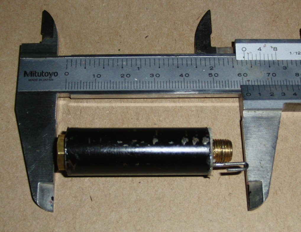

I'm currently making a micro hybrid with a burst disk in a compression fitting, making this for single shots but a cartridge will probably be similar.
Posted some development in the mini-hybrid thread but it belongs here really.
It would appear the "non burst disk" idea is feasible with o-rings, but now a question of etiquette, do I stick with the tiny 0.177" BBs - especially after finding out that power is a little on the low side even at 16x from a small cartridge - or do I go for something with bigger balls?
About 1/4" in this caseilovefire wrote:how thick are your epoxy plugs?
No vid I'm afraid, as it can only hold a 4x mix the spark gap is far too small at it won't ignite at that mix. In any case, now that I've gone to 16x I'm not interested in something that lowand have you tested it yet? cant wait for a vid
