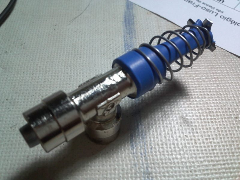

Ok I'm about to order the solenoid, jack are you sure it's strong enough? I still need a hit of 2kg for the valve to work safely and reliably. Just to make sure I won't be wasting money.

If I uses electric hammer, I could make selective fire, like single/semi/full auto

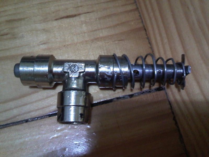

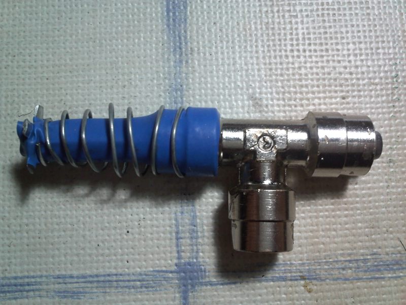

here is a pic about the finished valve.

wyz2285 wrote:If I uses electric hammer, I could make selective fire, like single/semi/full auto
aah me sees but... for that 3kg explosive kick... cylinder me thinks!

wyz2285 wrote:Ok I'm about to order the solenoid, jack are you sure it's strong enough?
I can't really tell, it "looks about right" but it depends on what voltage and current you're going to put through it, how heavy the hammer is, how far it will travel, how much friction it has to counter...
I would go for something bigger to be honest.

1kg is more than what i need, that coil says to have 0.8 N holding power, it should be enough, the hammer will be light, actually from what i see in the photo of the coil, it already has a injection pin that looks heavy enough, travels 2 cm, hope it works. So now i should worry about the firing circuit, can somebody that knows electronics show me a simple semi/full selection fire circuit for this? That would help a lot.

Have you been able to get your valve to seal yet have a manageable amount of friction? without that I don't think you'll be more successful than jack at this design. have you considered a valve setup like the one's in electromagnetic paintball markers
you could do the same thing only you'd replace the air cylinder with a solenoid overall the valve should have less friction

I'm wondering why the spring looks so heavy. This shouldn't really need a heavy spring to operate. You should use only enough tension to keep the valve from bouncing. That will minimize the force needed to open the valve and will improve power at the same time.

I only need 0.5 kg to open the valve, low friction because i used o-rings to seal, no leaks :D when the coil arrives i will make some test to show you guys :)

Your valve will leak through the " exhaust" hole at the moment it passes the o-ring.
You'll need two to keep it from blowing air straight into atmosphere.
I've made that particular design, but handoperated.
It kind of disappointed me.

:lol: 100 psi was like a dream to me too :lol: but now i have more than 600psi available for this :D yeah i thought it would needs 2 o-rings in the back for completely seal like a slide valve, but after testing with a hammer, the lost of air is insignificant, specially consider a solenoid would be faster than a hammer
Found out that I need to protect the valve from dust, so I cut a section of a small ballon, worked nicely :P
