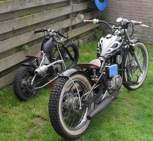

For those of you who missed it, I used a pitbike as a base and took out the shock.
Then I welded the hardtail after removing several unwanted frameparts.
I formed a seatpan from flat sheetmetal and over the weekend I glued and sanded a piece of foam.
Then I made the leather cover and started with the needle and thread.
Looks like it was custom made by a bikeshop if you ask me. 8)
I also cut the ( plastic!) sides off a scootercase and "welded" the two parts together using a flathead screwdriver and a stove.
I amazed myself...never thought it would work that well!
It is now a single piece and is used as a tankcover.
I could make a complete tank this way, but I'm not sure it is gasoline resistent.
I'm hoping I can "weld" an inner tank from the original pitbike tank in a similar way.
If that prooves impossible I'm stuck using one from a minibike.
enjoy the pics so far!
