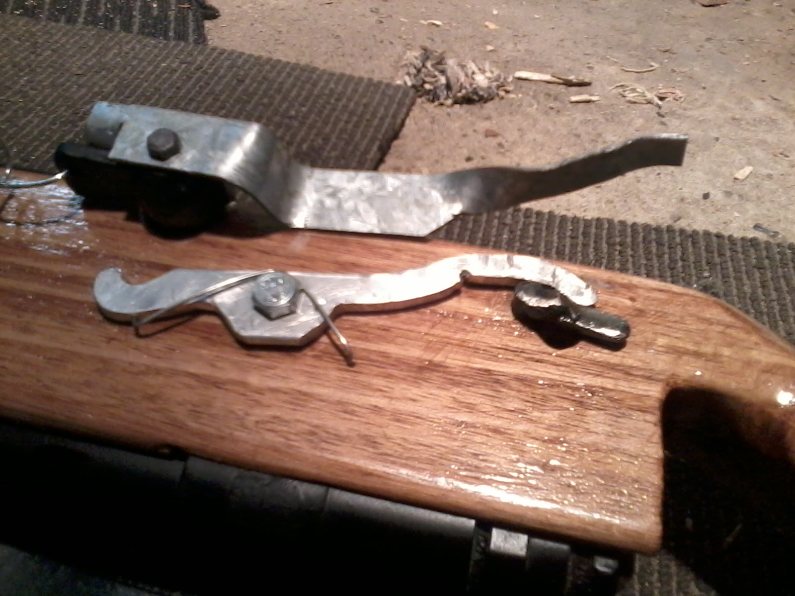

Trigger setup / cocking lever<br />Trigger is in the center of the stock, accesable througha  grove on the other side, it turns the small dark piece of steel anticlockwise, which turns the aluminium part and releases the ball valve lever
