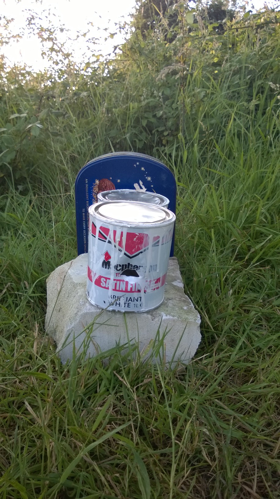

Got my 12mm (just under 0.50" to you guys!:) few parts short for my guuun so it was a bit of a jhash together, mainly for testing. I used the Parker 3/4" QEV along with an unknown sized tank constructed of 42mm copper tube, I just made it the length of pipe I was given, I estimate it to be 65cm long. Therefore way larger than required. The barrel was supposed to be 12mm i.d. but I drilled it out with a 12mm drill. My slingshot BBs are now a perfect fit, I did a bit of testing around 120-140psi and all was fine. Ramped it up eventually to 275psi (too scared to go higher). It doesn't look pretty butm am pleased with rthe power
The photos show how the Tins and block was arranged and it was taken from point blank, but still I am really pleased and it has given me the incentive to use high pressure components and use a few more psi, not sure how much the new barrel helped as it has almost doubled in length, so I guess all the excess air I am using has been working for longer.
Thanks to everyone who helped me along the way, couldn't have done it without your help.
I hope with a few tweaks I can run it off workshop air at least for practise and mucking about as local refill place is 15miles.
