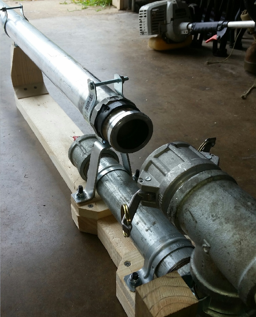

A few changes since last time. Coming up on 2 years into this project, but some things get better with age. (Not me obviously)
I got a sudden surge of productivity in between projects and decided to build a mount and put the cannon through final finishes early. The main goal for the mount was to make for an easier loading experience. That has been accomplished by making it so that the barrel can be slid forward to reload. The mount is made primarily of wood and holds well. Then finally I slapped on a fighter jet gray "Stealth" coating.
I am now preparing for OT-2 (2nd phase of Operational Testing). This includes modifying the piston and building a new meter to support a 9X mixture (Mach 1 Capability). Over Thanksgiving, I will test it to full capability and will Chrono it to confirm that it is attaining Mach 1 muzzle velocity. Assuming that all goes well, I will then upgrade all the support equipment and integrate everything into an easy to use control panel so that even a novice could fire it. I intend to post a video of OT-2, assuming I don't die.
Side Note: Firing off a blank in the garage with the garage door closed in a suburban neighborhood is still loud enough for someone to call the police. There was a gun drawn and everything.

Looking good. I wonder why you chose 9x as a final mix though? 10x is a nice, round number. :D

mark.f wrote:Looking good. I wonder why you chose 9x as a final mix though? 10x is a nice, round number. :D
Mark- I would like it to be 10 but I need to get a more powerful compressor first. The one I have in Texas(Not even mine) goes to 120. I am not even sure the compressor I am using at the test range will get me high enough for 8X. We shall see.

Delayed Again. For those who don't know, the reason testing is so complicated is because I have to go off site into another state where there is a place I can legally and safely fire it. I can't do it at home because I live in the city (where they frown upon such things) and because I have not gotten an official determination if it is even legal to possess in the state of Texas. (I have a lawyer friend looking into to it for me)
So, I am ready for OT-2. The new meter is complete and mounted. This will allow me to test up to a 10X envelope, but I will likely only go to 8X. The piston has been modified and the stabby part cut off. I will have a camera rolling and a chronograph on hand. Testing will commence Dec 23rd and I will post metrics as soon as I have them. My hope is to close this thing out and have it in the showcase by the end of the year.
