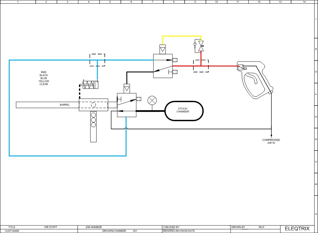

Worked on the circuit a bit, going to get some parts and make a test set up of this.
Pulling trigger should operate main valve then operate the control valve after a short time set by restrictor, which shuts off main valve and opens breach to load 1 ball. Releasing trigger should reset valves ready to fire again.
On initial loading, before firing, 1st round can be loaded manually as breach cylinder is spring return, just like a real gun.
