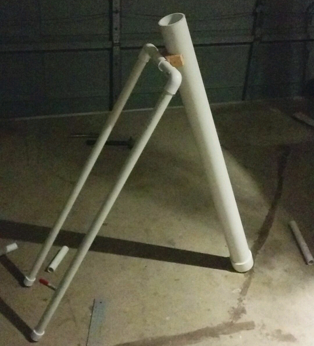

A friend and I are making a mortar that fires foam projectiles powered by 12g CO2 cartridges. It isn't anything fancy, just a 3" PVC pipe with a nail at the bottom to puncture the cartridge and a bipod to hold it up. It's 4 feet long with a 3 inch bore, and can adjust it's trajectory between 45 Degrees to 75 degrees, just as the original Stokes mortar did.
I'll be uploading pictures of the finished painted product, various experimental shells, and possibly a firing video, along with the customary data on ranges and ballistics. If anyone's particularly interested I'll draw up some blueprints for you.

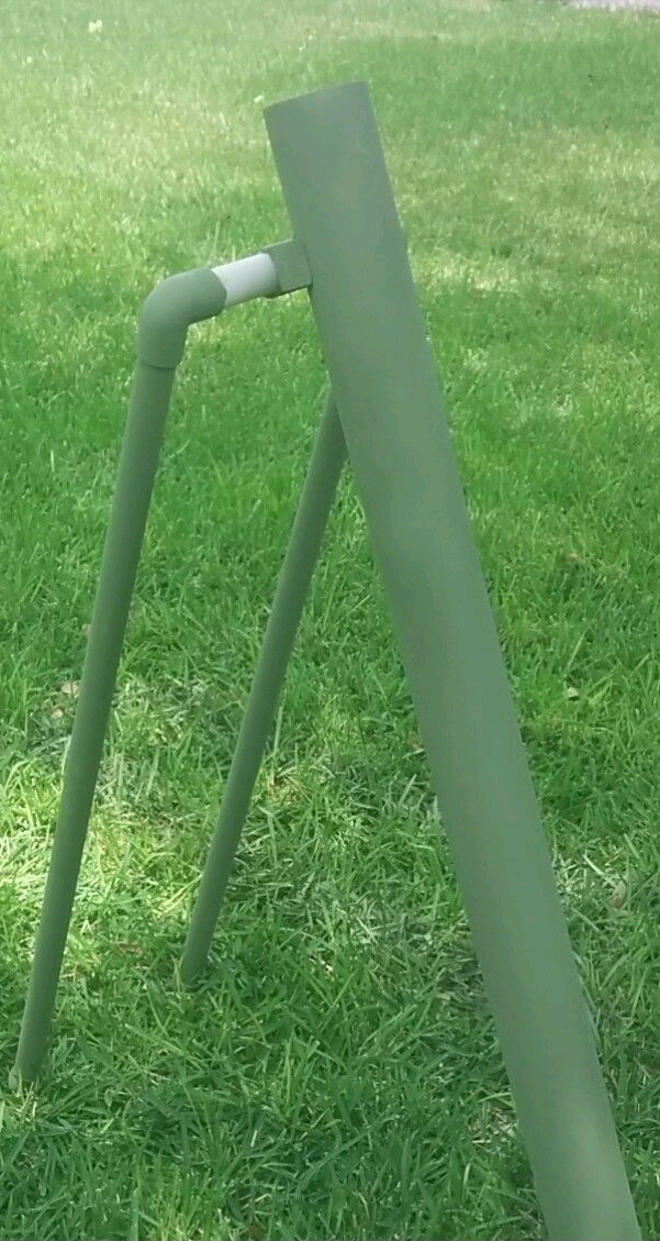

Well, I threw on a couple layers of olive drab paint, it's a bit spotty and I left the Axel it hinges on unpainted (it would rub off there anyways), but for all things considered it looks pretty good.
