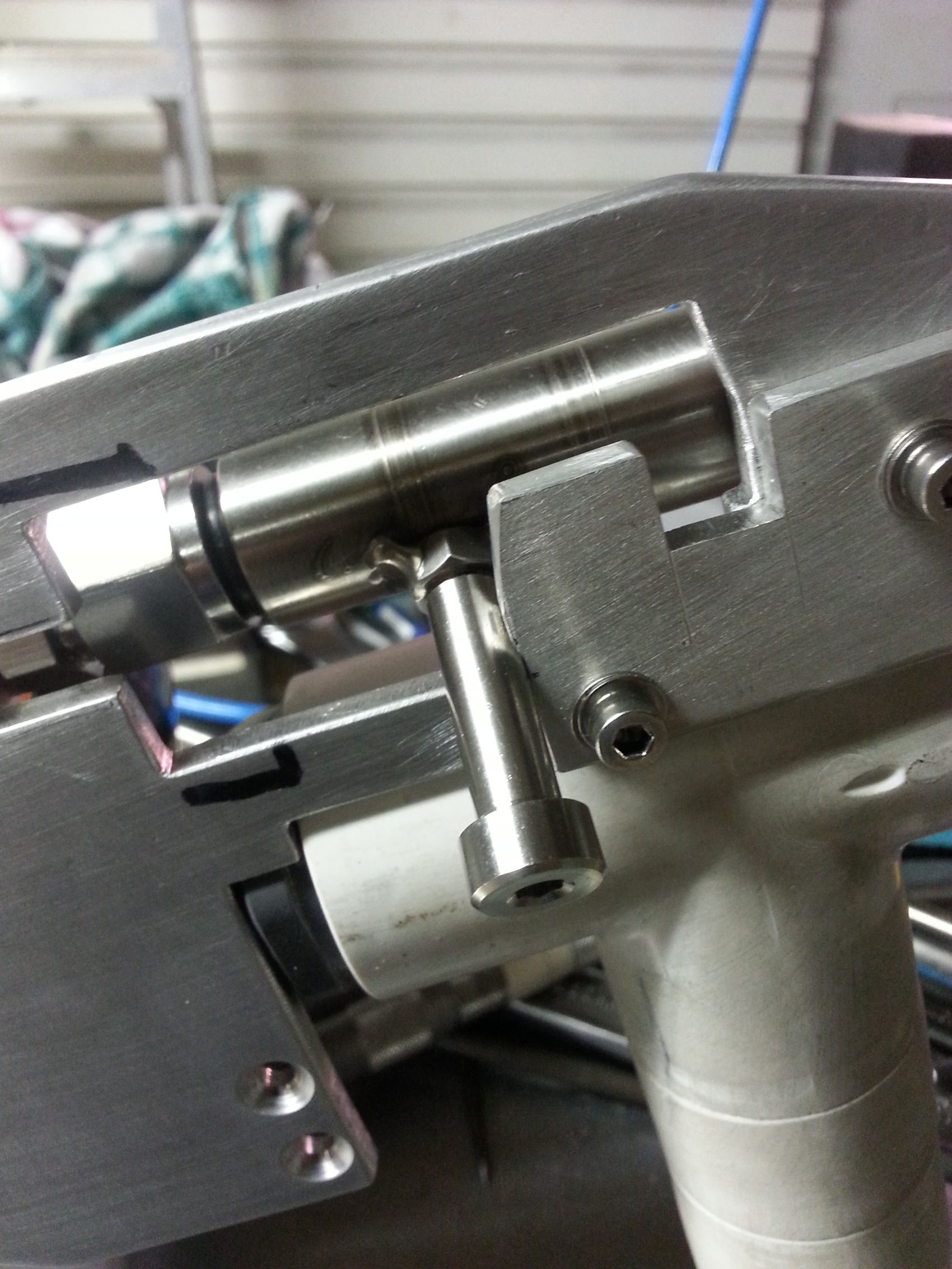

As usual I had a change of plan, ditched the burst fire, going for single shot, as I originally intended. Found a sweet piece of pre-drilled 20mm round bar which I opened up to 10mm ID in the drill press, (oh for a lathe)
Bolt open (no hole in barrel yet)
Closed, locking ramp puts pressure on O ring as I want the barrel hole close to the end, the plate fixing bolts are in slots so I can adjust the pressure on the Oring

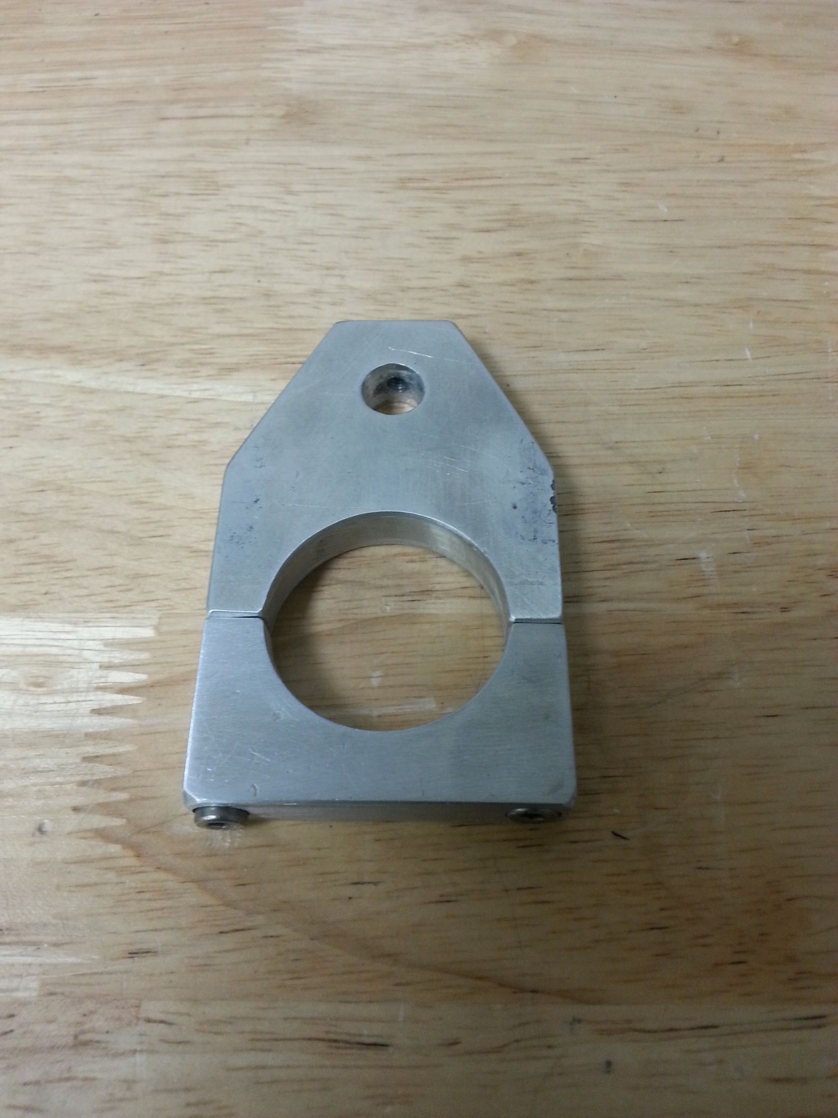

Made a clamp today for the front section of the gun to secure the barrel to the pvc chamber
M4 thread on top for front sightpost

Some mods in progress, changed bolt to left side, I'm right handed but find it easier to load with my left. Mounting scope bracket, making dummy flash hider.
