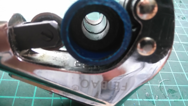

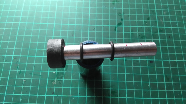

Plan B:
To make it, obviously you need to make "rod seal" type, which is head-scratching, since "piston seal" is easier and more common. Materials: solid rod (got to make 2 inline holes with exits at appropriate distances), matching o-rings, and the body (I used ABS tube and knowing for sure, it wouldn't crack - as the fiberglass body would have to crack first) with fiberglass casting.
1) Rod with o-rings, ready for fiberglass casting deployment. Be sure to oil the rod's body first.
2) 24 hours later, and poking the rod out, revealing the fiberglass body, with o-rings exactly where they supposed to be:
3) Epoxied (JSR gonna like this) the threads to the rod's body. Since all the parts of my launcher are "serviceable", had to create ways to make this slide valve serviceable too, esp the o-rings, if need replacements.
4) Ready to test:
Comments: Sadly, there are leaks. I wondered if the o-rings were misplaced, or the cast body got leaks, but no, the problems was the o-rings area, where the edge/sides covering the o-rings have some "casting imperfections of fiberglass". I was genuinely !@#$%^&*
5) A day later, decided to make another one, with better precisions in the casting. Ex: wiping off any greese from the o-rings before casting:
Conclusion: Same leaking issues as the first one. No matter how careful, the casted edges of the o-rings always have some sort of imperfections, creating paths for leaks. I am beat.
Anyone with better ideas of casting, so that the edges surrounding the o-rings are "perfect"?

I recognize that construction method :) are the o-rings tight around the rod though? If you don't have to stretch them to fit them, you will never have a good seal under pressure. They look pretty loose and I think that is your main issue.

JSR. a day after the second attempt, i had that thought exactly. The orings only had "nice fit" on the rod. Not loose, nor too tight, but just nice. Even the rod slides in and out rather easy. Interestingly, if i rotate the body around, at some point, the leaking just stops.
And so, this gives another incentive to try the third attempt, this time with tighter orings around the rod. I have this question though: if i use tighter orings around the rod (having to stretch them on the rod), what will happen to the orings and their sockets after casting is done, and the rod poked out? Will the orings return to their smaller dia (pre-stretch) and come off from their sockets? Or the sockets would be tight and hold on to the orings' exaggerated stretched dia?
A.Duo, the fiberglass resin + MEKP mixtures have very low viscosity. I used these mixtures before to replicate gun's body shape from hollow toy guns, and details were amazing. I am sure JSR can testify to its viscosity. ;)
Sun Aug 13, 2017 3:24 am
airatomic wrote:I have this question though: if i use tighter orings around the rod (having to stretch them on the rod), what will happen to the orings and their sockets after casting is done, and the rod poked out? Will the orings return to their smaller dia (pre-stretch) and come off from their sockets? Or the sockets would be tight and hold on to the orings' exaggerated stretched dia?
As long as there isn't too much of a difference in diameter between rod and unstretched o-ring - I would say less than 1mm - they should remain in their groove.

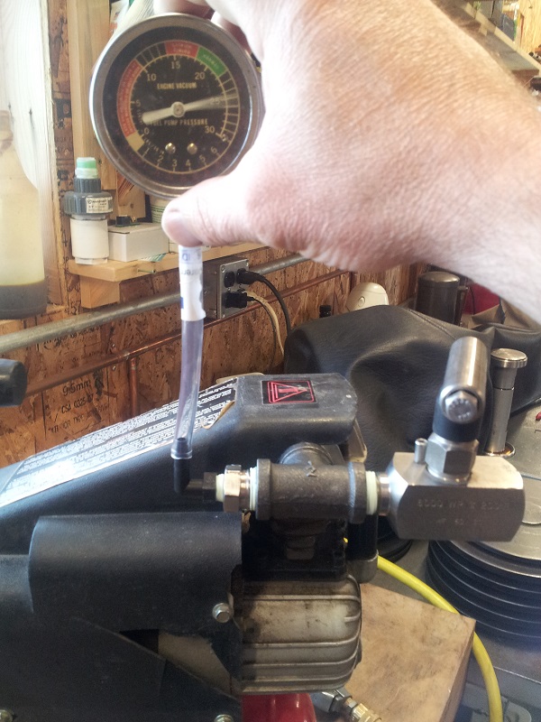

Any chance of finding the right size tube to use between the o-rings? Short sections of tube sanded square using the drill press....
Have yet to buy a vacuum pump for the garage, but I did have an old piston type compressor kicking around....couple fittings and a 1/2" needle valve from the junk bin threaded into the inlet and.....
