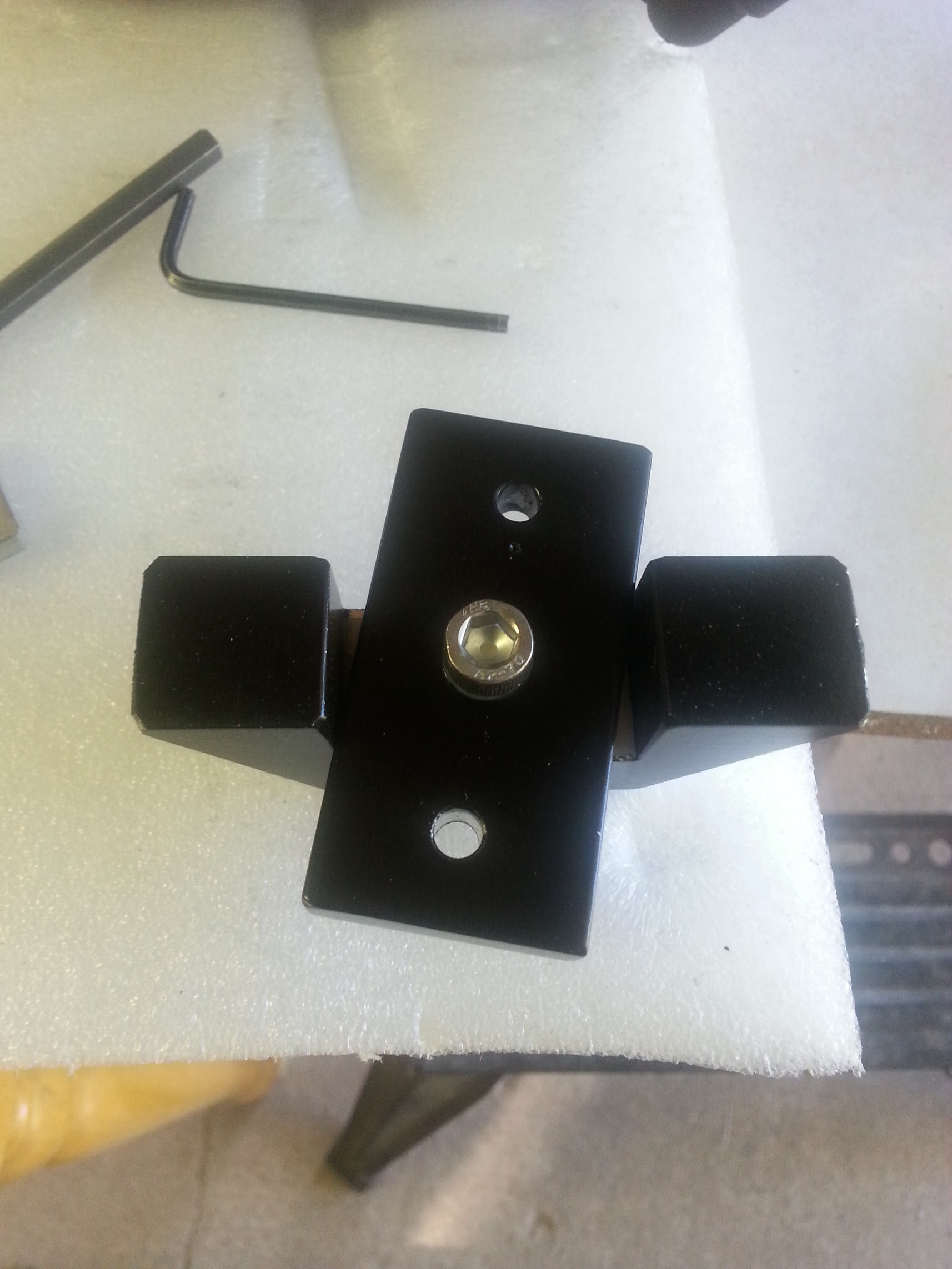

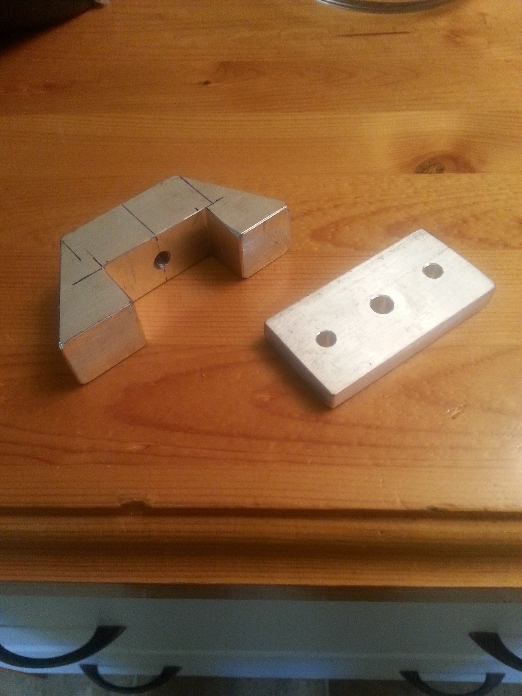

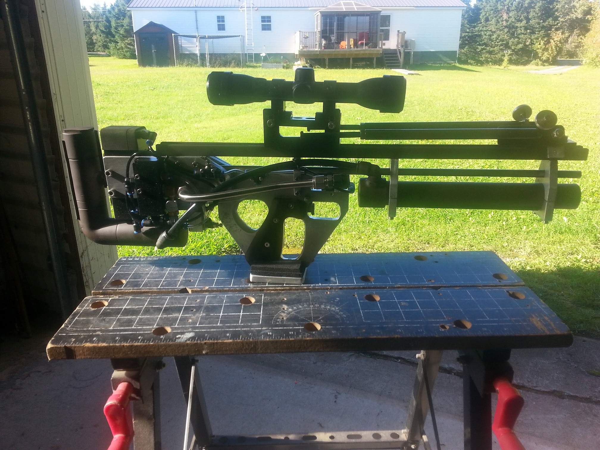

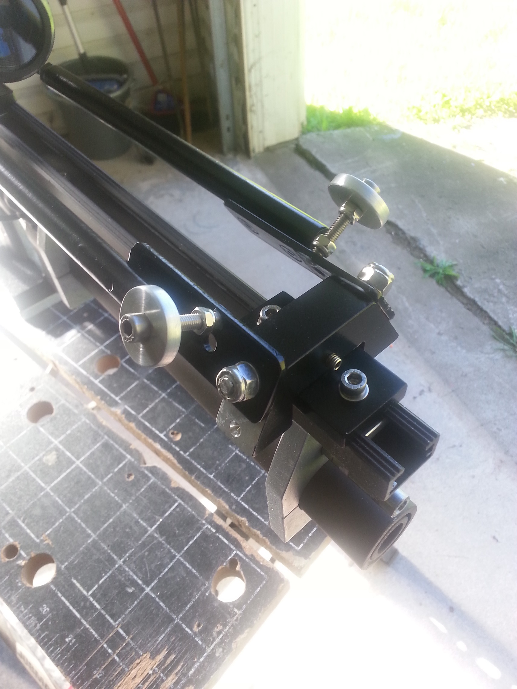

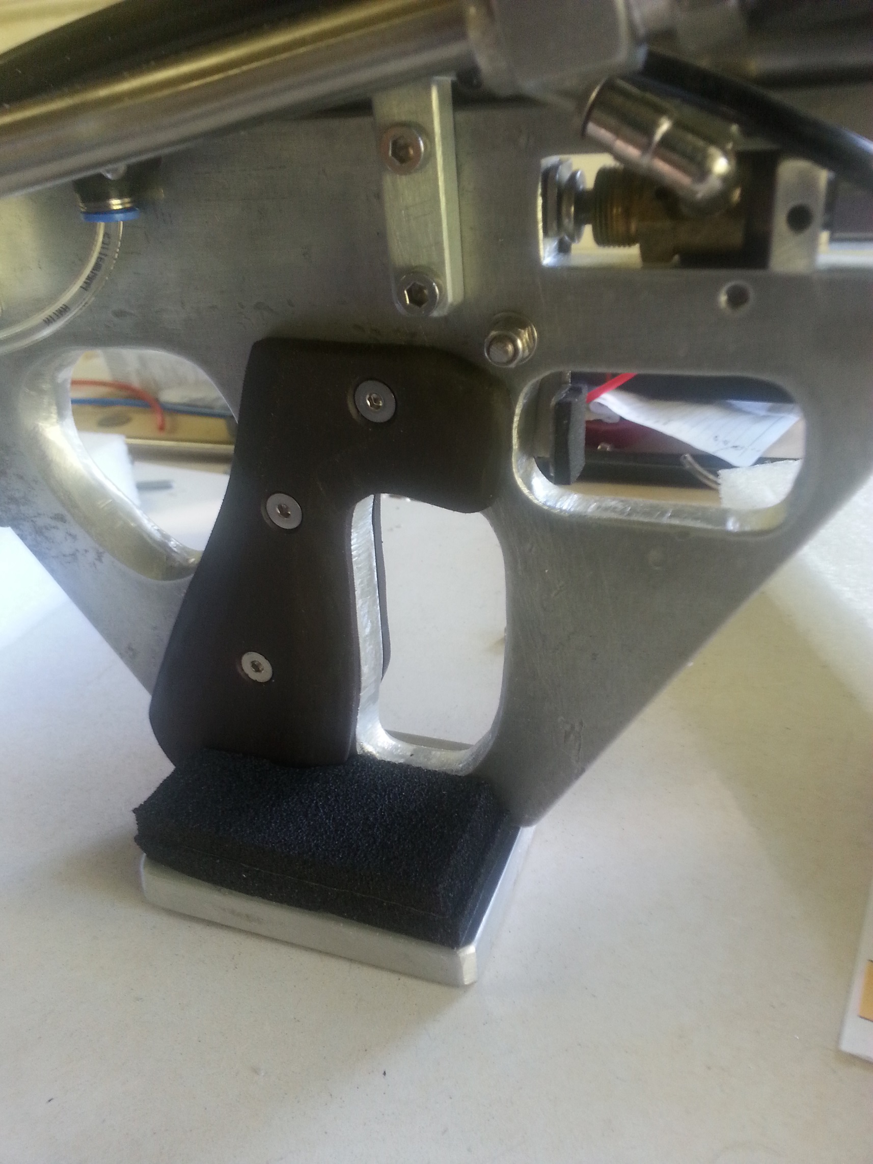

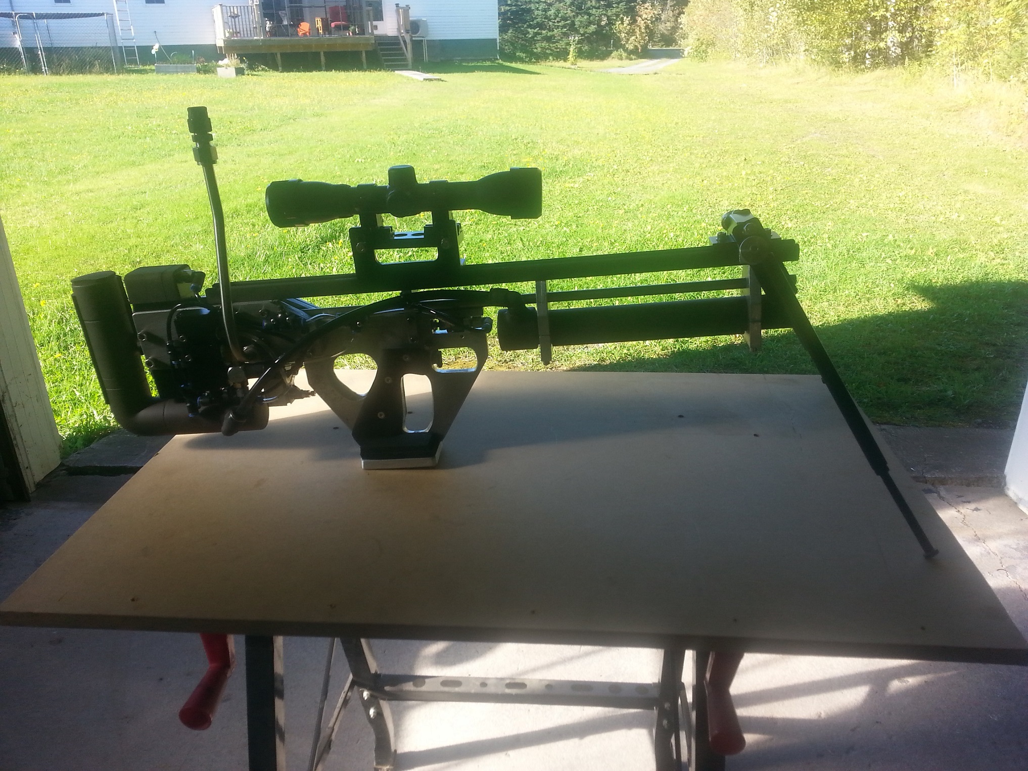

Got it finished with some work on the bipod and grip, video and full specs. to follow.
Bipod can turn slightly left and right

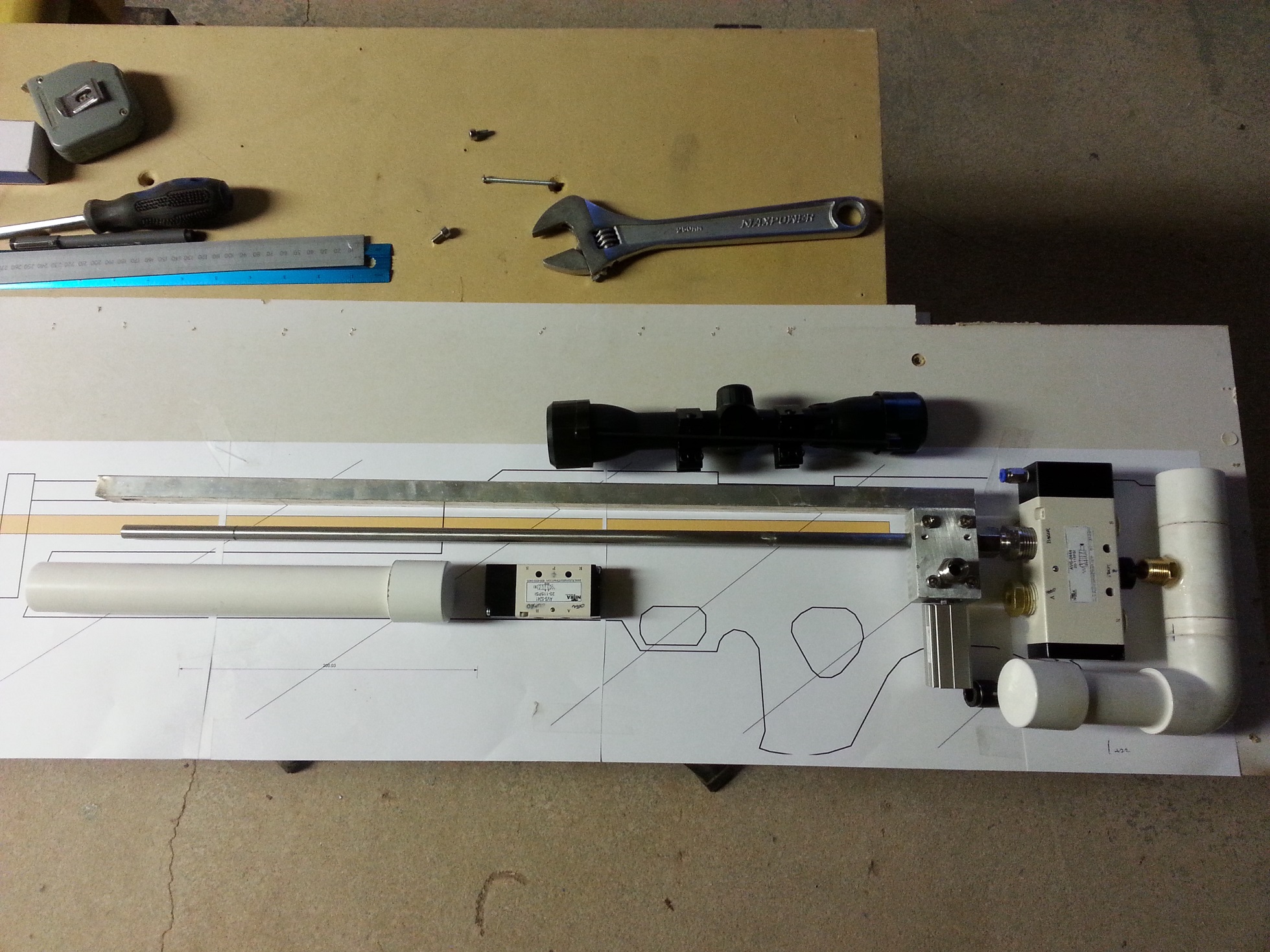

Make a scale plan (I use Microsoft Visio)
FAR2017 main - Copy.jpg (31.61 KiB) Viewed 8899 times

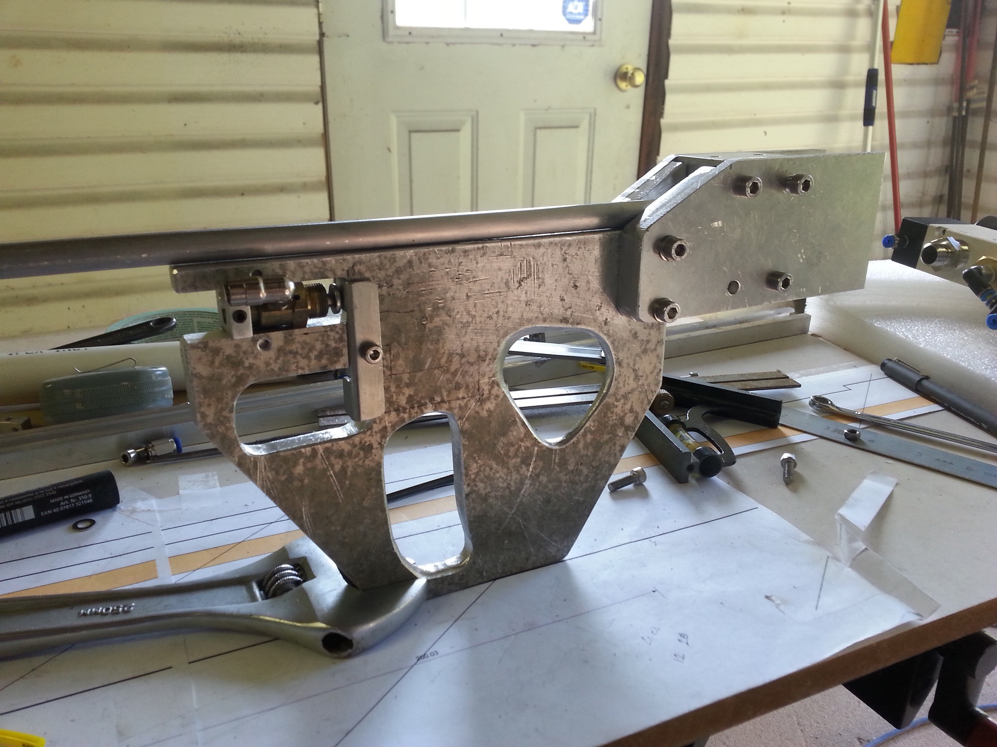

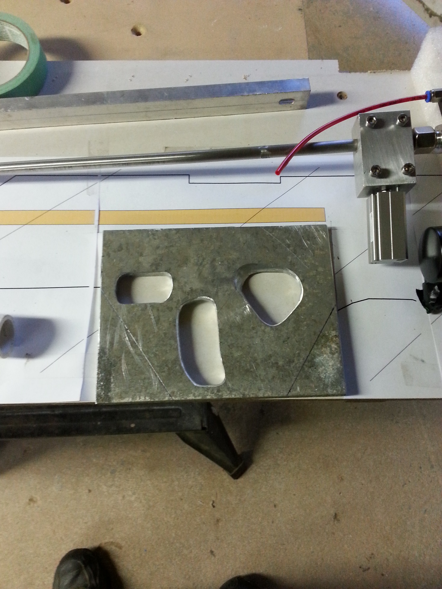

Get some parts and see how they fit

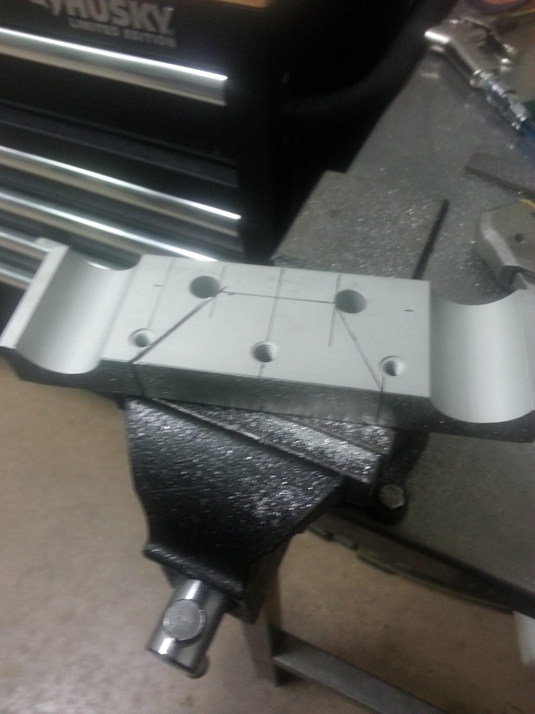

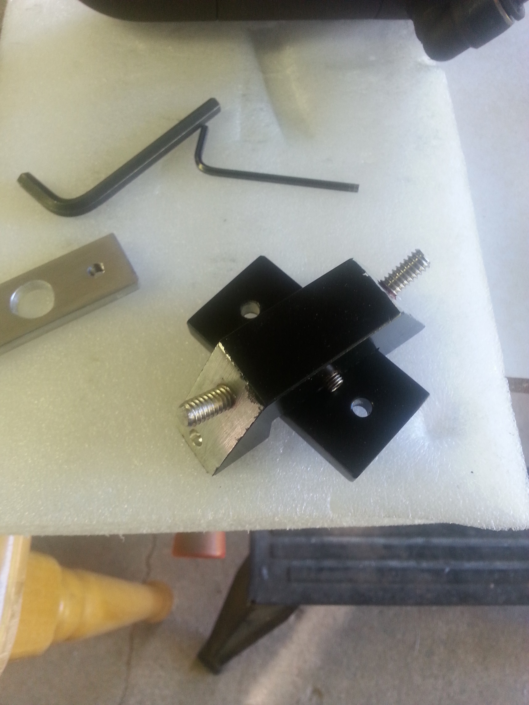

Make some more parts

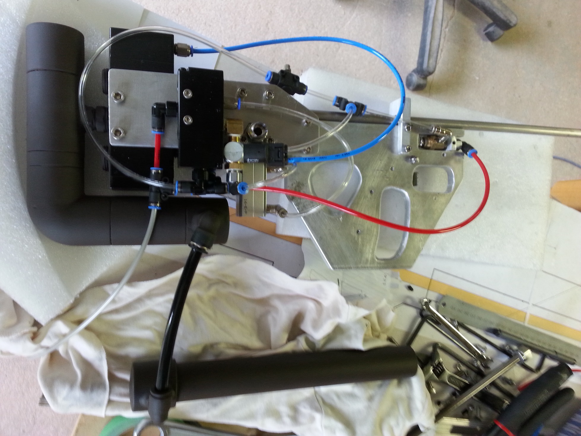

Work out pneumatic circuit

Put it all together
It is 700mm(27.5") long.
The barrel is 10mmOD 6mmID stainless steel, 500mm(19.5") long, 800mm (31.5")with extension.
Chamber is 1" Stainless Sch40, 250mm (10") long.
Weight is 11.2Lbs (5Kg)
Main valve is a 5/2 1/2" port air pilot, control valve is 5/2 1/8" port air pilot, trigger valve is 3/2 #10/32 push button momentary spring return.
This magazine tube holds 50 airsoft BBs, I will be trying it with steel BBs as well.

Finally got the video done, not very exciting as it all happens inside. Used a 20 round short magazine, have a 40 and a 50 as well. I can see why some people like the bullpup style, with the barrel extension on it is perfectly balanced at the grip, really nice to shoot from the sholder. Pleased with how this one turned out :D

Hi, i've just been looking at your FAR2017 again, do you have your main and air chambers connected?
farcticox1
Canada
Posts: 1084
Has thanked: 69 times
Been thanked: 100 times
Sat Nov 18, 2017 8:12 am
Yes, mainly to increase the volume, I use it with the air supply always connected but only through a 4mm airline, so it tops up the chamber between shots.

Hi F1...have been reading your thread again, and noticed with your 1" chamber you said you split it into 2..?
What does that do?
farcticox1
Canada
Posts: 1084
Wed Nov 22, 2017 5:48 am
Ah sorry, I thought that was what you meant before. I just wanted to get as much air onboard as I could. At least 4X barrel volume. The feed line from the compressor is 4mm OD Polyurethane which is so small you hardly know it's there, BUT it has very low flow so it is mainly there to top up the onboard chamber between shots. Originally it was going to look like this

I noticed your feed lines, do they handle the pressure ok?
Feed lines would be great to eliminate attachments between the trigger and the qev, etc.
farcticox1
Canada
Posts: 1084
Wed Nov 22, 2017 5:28 pm
Everything except the PVC chambers are standard pneumatic components, valves, fittings & tubing, I think they are rated at 120psi, I'm using 135psi so I guess there is a good safety factor anyway.
