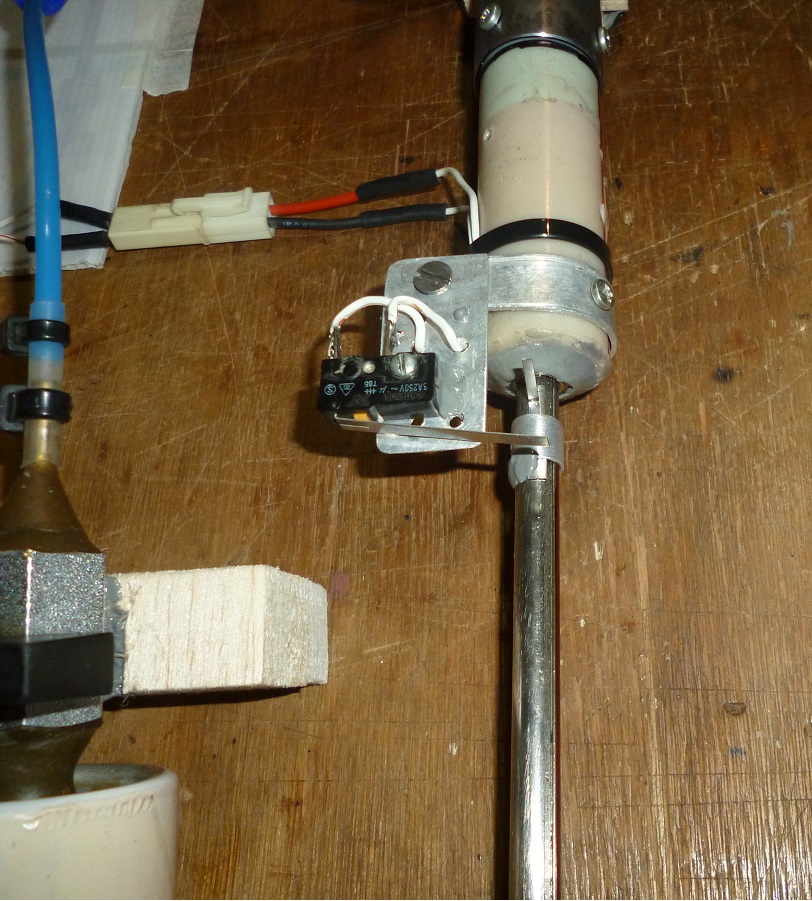

The timer consisting of a 12-volt relay in the coil is controlled by
an electrolytic capacitor of 2200 Uf. He is in charge of keeping the electrovlala activated
5/2 to allow time for the output of excess gas from the dispenser - "E" gas injector.
The more capacity the capacitor has, the longer the solenoid valve is activated,
as necessary. The contact that activates the solenoid valve is actually a push button
which is "pressed" when the piston rod that sweeps the burnt gases from the chamber
of combustion is in the position of "volume 0 combustion chamber", totally clean.
I have contributed a couple of photos of the timer and the contact.
