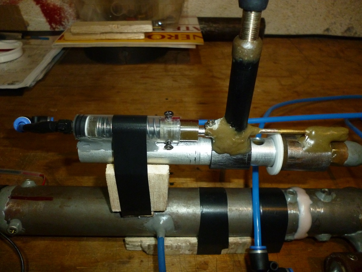

Speaking a bit about the "Franky", I am rapidly manufacturing the automatic ammunition loading system. I'm going to use 6mm airsoft balls to test, since they are not very harmful, if you keep in mind that I'm on top of the "little monster" circulating in front and back and sides. When I have it ready, I film it and show it to them. 8)

I have integrated into the "Franky" :D a 6mm airsoft ammunition loading system, test. It is simply the same system that I have in the combustion weapons that I have built, but in this case, moved by a pneumatic actuator, commanded by the electro valve. It is of improvised construction, but it works correctly. With this, the design concept tests are concluded. As soon as I can, I'll upload the video of this working.

The horrible noise that is heard is a check valve that sounds .... It is the Franky that begins to breathe !! :shock:
On the other hand I had to move before, and with more care, the small 100 mm long gun, so that all the holes do not coincide in the same point :evil:
