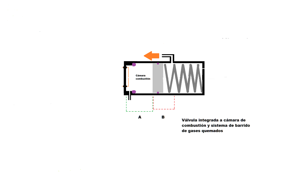

I was doing some tests and corrections to this system for hybrids.
The piston was separated from the spring guide rod, it no longer has it, and the weight reduction of the piston is large. Before, it weighed 139 gr, and now weight, 28 gr. The shank was an iron 20 cm long by 11 mm in diameter, very heavy. Immediately the thing started to work properly, producing a small powerful and dry explosion, as happens with the other small hybrids I have with a rupture disc.
The bottom issue is to regulate how far the piston should go when the mixture is compressed, "A" in the diagram, I mean, the distance to the exhaust hole, "B" ..
If it is too close, the piston opens the exhaust hole very early, and the maximum pressure never occurs. The result is a blow only. Otherwise, if the piston is some distance from the exhaust port, the maximum pressure peak during combustion if it occurs, and everything behaves as if it had a rupture disc.
I used a single 100-pound spring to hold the piston during the compression phase of the mixture and to return the piston and clean the combustion chamber after firing. The diameter of the combustion chamber is of 3 cm and when it is with programmed pressure of mixture, it has 6 cm of length, the volume is about 40 cm3. Burns 7 cm3 of butane, for 160 cm3 of air at 4 bar.
In this test weapon, I used a commercial 5.5mm spout with grooves.
I will prepare a small video of the experiment to see it work. It's interesting for me, not to make more rupture discs. It's simpler to just load the ammunition alone.
I have to get a harder spring, 150 pounds, to take it to 7 or 8X. Currently shooting at 4X.
In summary, it works perfectly without energy losses, although it requires some calibration work to synchronize the opening of the exhaust with the maximum possible peak pressure. It is very simple to build, and the only thing that must be taken care of, is not to leave burst in the exhaust hole that is 4mm, so as not to destroy the o'ring. :D

Looking good! Is the port sealed by the piston significantly smaller than the piston diameter, to give a pop-off effect?

Actually, the diameter of the hole that I used for this test is by the oring, and because it is very similar to the other two .22 caliber weapons that I built. These are the two reasons.
The first.
The oring has a diameter in its sectional cut of 3mm, and if the exit orifice is larger, the oring is damaged ....
The solution, if necessary, I think it is not necessary, is to drill 5 or 6 holes, (or the necessary), about 1mm, around the combustion chamber and attach an outlet that collects the gases of all holes and eject them by one. All these holes added, should be equivalent to a large exhaust hole, but each, not more than 1/3 of the sectional diameter of oring. In this way, it will not be damaged.
The second.
In the other small hybrids, the output port is no more than 5.5mm. In the place where the rupture disc they use, the output is 5.5mm because the ammunition is there, which is the port of departure, based on this empirical information, use something similar in this test.
What I like is that it can be regulated with the force of the spring, the moment in which the exhaust opens, only adding or removing some washers to compress more or compress less the spring, in relation to the longitudinal position of the exhaust hole that is fixed.
It is the only way to explain that using 6X the weapon has less power than with 4X, which is what I observed in the tests.
This happens because in the case of compressing to 6X, the piston is very close to the exhaust hole because the spring is more compressed by the higher pressure, and the outlet port opens before the pressure peak, not allowing this peak Maximum pressure is realized. In the case of compressing to 4X, the piston is further away from the exhaust hole, because the spring is less compressed by having less pressure, and giving time to the mixture when it explodes, to achieve maximum pressure just when the orifice is opened. departure. I do not see another explanation for what was observed in the facts.
The lengths traversed by the piston regulate the system time. More route, more time and in reverse, all this taking as reference a fixed point in the considered trajectory, in this case, which is the exit hole.
 The pressures that are used are in direct function with the strength of each spring. The mass of the piston for a given force, logically, also influences the time. A more mass, more time, and vice versa. :shock:

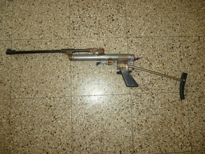

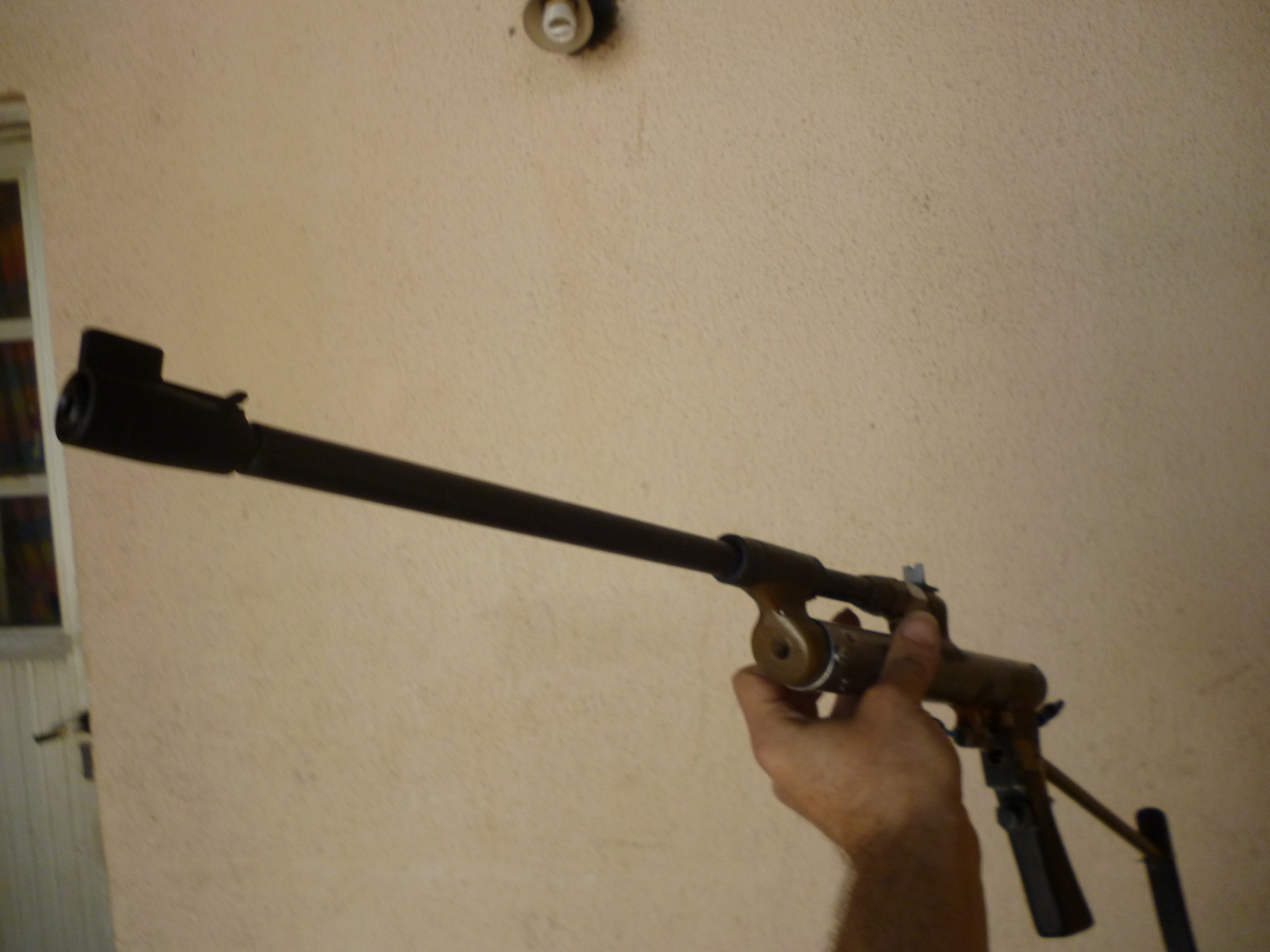

Fri Mar 02, 2018 4:46 pm
4X shot test that is as far as the spring I have.
The "weapon" is only to be able to shoot safely, outside of my workshop, because it is very noisy. I will try to make a basic silencer.
I am almost determined to use this valve integrated to the burned gas scavenging system, for the semiautomatic.
It has the same power as the first autonomous hybrid, with the difference that this hybrid cartridge with bursting disc burns 13 cm3 of gas and this, the video of the test, 7cm3.
Dejo un par de fotos. :D

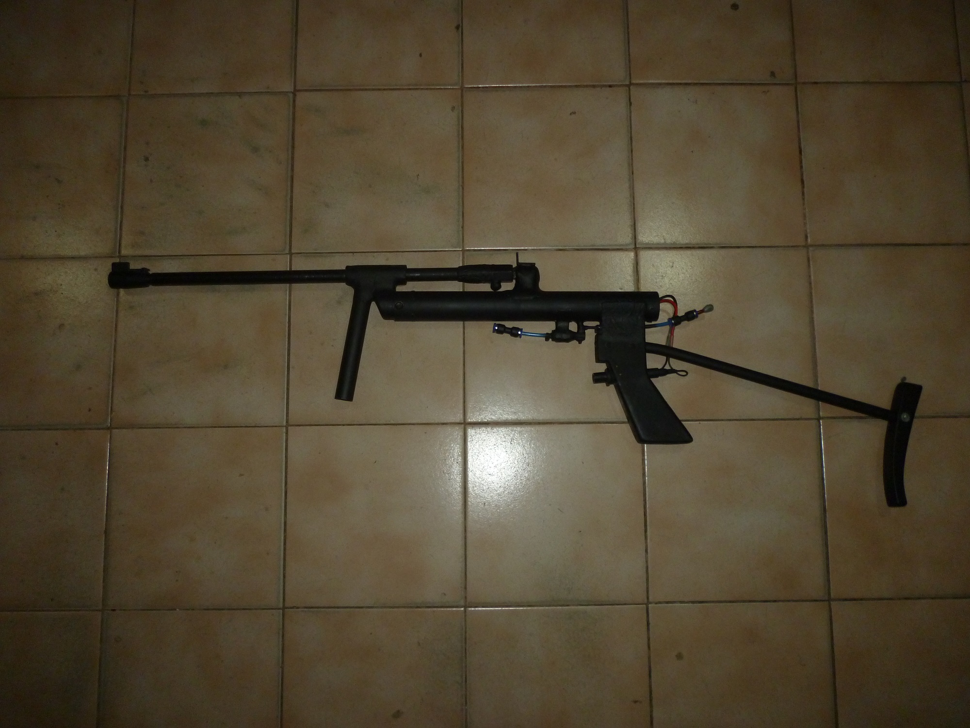

Here I have a picture of the "invention" painted to make the appearance more aesthetic. Thanks Air2theBrain :)
