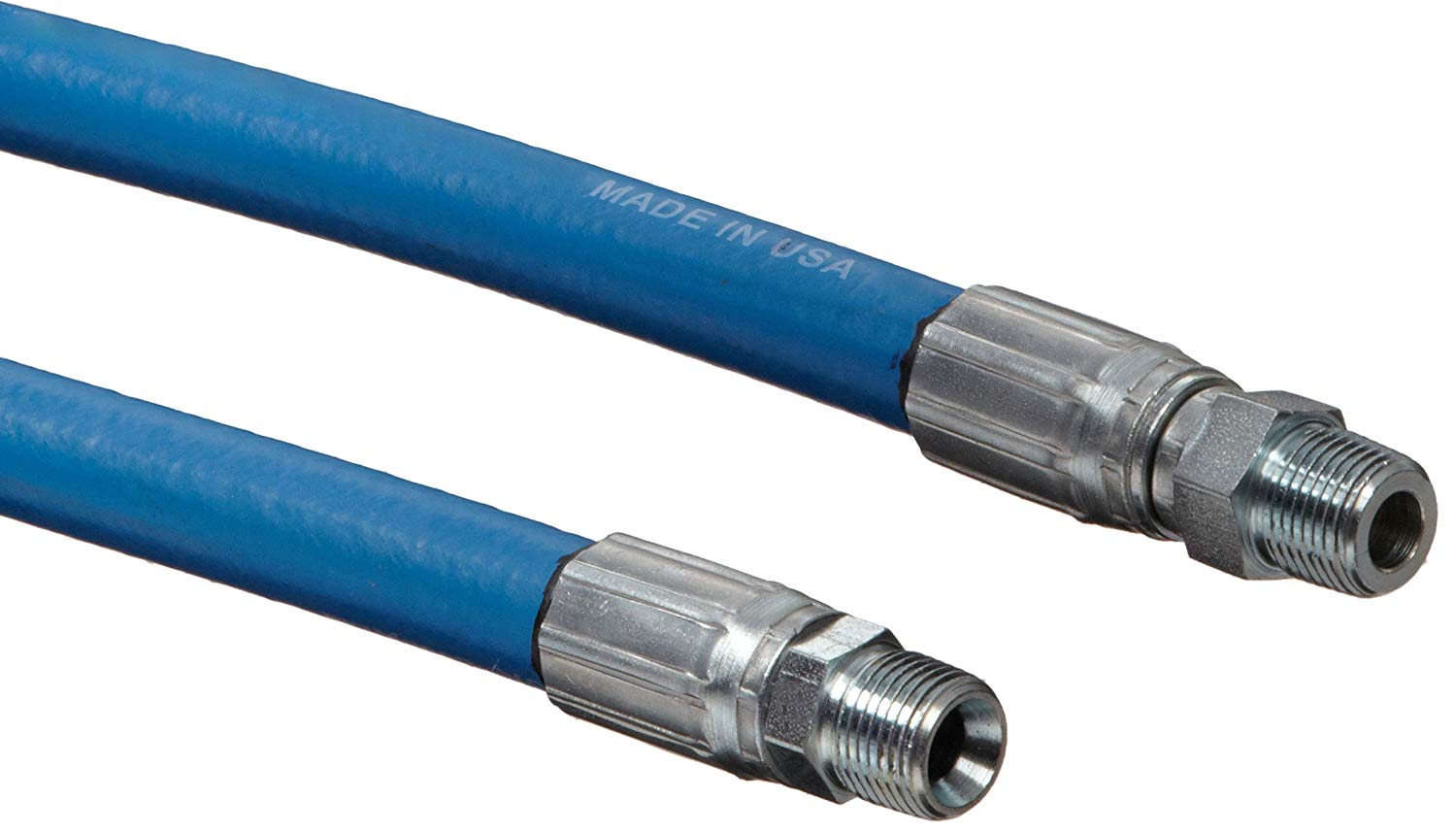

Yes, we use stuff at work rated for 3000psi, 3/8 ID single wire reinforced, it is somewhat flexible. The ends are hydraulic crimped though.
It looks like this.

That pressure washer hose would be a good option. Very similar to hydraulic hose. I believe most of the commercial stuff actaully has regular 3/8 pipe thread. The ones sold with home use electric units use a 22mm thread.
