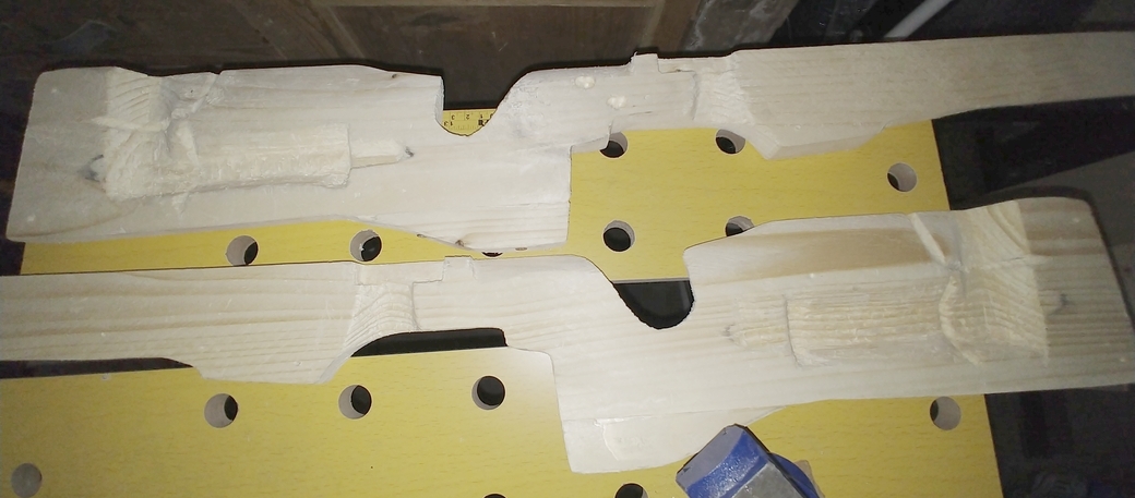

Wed Apr 27, 2022 2:47 am
Work in progress.
Managed to make the stock (it took forever!) using two wooden board and a plywood board for reference, modeling and carving them for inletting the parts was quite hard with hand tools, huge respect for those who didn't use power tools and got pro results.
Trigger ready, I had to use two springs for the upper part 'cause the spring on the slide valve is quite strong and a single spring on the trigger couldn't hold the valva in place. If someone has a better design I would be interested, it's kinda working but maybe there are better solutions.
Cheers,
Andrea

Sat May 07, 2022 7:26 am
That is a lot of work!
Nice to see a mechanical trigger. Also the metal liner to hold the trigger and sear is a great idea.
There are several other ways to set up a sear to hold back the valve but would require almost total redesign. If you can get yours to work I would stick with it. Basically I would set up the sear so the pivot is at the far left. The slide will push the sear against the pin and be jammed until the right side of the sear is lowered. The trigger could be part of the sear but might feel weird.
It looks like you could eliminate the trigger return spring. The trigger side of the sear will press down on the trigger and hold it in place... I do that a lot in my designs (doesn't always turn out the way I think, but when it does it's an elegant solution)
We could start a whole thread on triggers... I have had a life long interest in them on crossbows, firearms, and spudguns.
