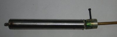

I'm made a similar launcher to the one in the original thread, only beefed up for HPA and with a rubber seal to enable airsoft BBs to be fired.

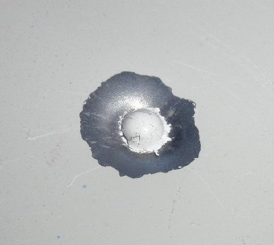

It doesn't seal perfectly, clearly an asymmetric locking of the projectile is not ideal - still managed to make some BB pancakes though :D no penetration but that's 1mm steel and I'm "only" using 450 psi:
No idea how fast they were going though, BOTH my friggin' chronys' batteries have run down!
BB pancake :D
BB pancake :D
yes, I know it's bent, just a proof of concept :P
Tue Jul 27, 2010 2:03 pm
something tells me that a QC gun is coming soon :D
Is it a single shot gun or do you plan to turn it into a semiauto/fullauto gun ? actually that isn't such a bad idea... you just need a similar locking mechanism behind the BB... so that it will block the nest round when the release mechanism opens

POLAND_SPUD wrote:Is it a single shot gun or do you plan to turn it into a semiauto/fullauto gun?
OMFG I can't believe I didn't think of that!!!!!!
I poured a bunch of BBs into the chamber, set the detent to barely let a BB pass and instant airsoft cloud BBMG, not BRAAAAP! but DAKKA DAKKA DAKKA and instant feed every time!!!!!
Apologies for the crap lighting, it's dark now but I think you can see why I'm grinning like a fuçking idiot right now :D :D :D
And here it is in real time, note the ridiculous amounts of shattered BB spilling out of the tin :D

well I suggested this when I noticed that mine worked so well...
back then I was literally
uhmm I mean before I got totally frustrated after spending so many hours tweaking the design to achieve reliability... with no success
but yours seems pretty reliable... have you tried adjusting the flow and/or the detent to bring ROF down ?? I think it is possible... well at least it worked pretty well on mine

Yes yes, thanks for pointing out the bleeding obvious which seemingly escaped me ;)

... but now that it's up, this is a better idea for a retainer/trigger than the original project.
Thu Oct 20, 2011 2:52 am
hmm Y U no build a proper semiauto with the same mechanism?
Has thanked: 581 times
Thu Oct 20, 2011 3:24 am
POLAND_SPUD wrote:Y U no build a proper semiauto with the same mechanism?
Working on it, first I want to make the ultimate pengun :D
... though for a 3/8" ball bearing, the diameter would have to be at least 16mm, so not really convincing as a "pen"... so perhaps in 0.22".

pneumaticcannons wrote:Omg jsr thats intense... i say go for the 0.22 maybe even rifling?
Rifling seems a bit pointless on a device than cannot really be aimed, besides diablo shaped pellets are more than stable fired from a smoothbore barrel.
hey! what happened to your hybrid pen gun :o
In the works, but I'm distracted by work and making knives pretty at the moment ;)
