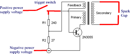

here comes your idiotic question of the day... how does the thing get activated? I mean i know transistors can be used as a switch somehow, but how would it worked hooked up to a remote ignition thingy? and in the wiring diagram, where do those two wires go off to that say high voltage??

See the circle with the plus sign on the left of the spudwiki diagram that says "6-24 V DC"? That is your positive power supply connection. Could be batteries or a wall wart or whatever you have to supply the voltage. The wart's (or batteries') minus wire goes to the circle with the "-" in it. To turn the circuit on and off you just connect and disconnect the power source. A switch would be a much better way to do it, see the drawing below.ilovetoblowthingsup wrote:how does the thing get activated? I mean i know transistors can be used as a switch somehow, but how would it worked hooked up to a remote ignition thingy?
Those go to your spark gap.ilovetoblowthingsup wrote:and in the wiring diagram, where do those two wires go off to that say high voltage??

Yep, when the "Trigger switch" is closed sparks jump beteen the electrodes.ilovetoblowthingsup wrote:so basically to create the spark, i would just flip the switch?
