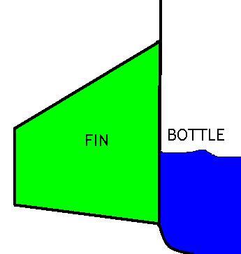

Interesting thoughts. I actually sat and read the whole thing a few times. I'm doing Projectiles in Physics at the moment, and seems like some good food for thought.
We're making stupid bottle rockets, and we're supposed to come up with an effective fin design.

Don't dis bottle rockets man they're awesome and an effective fin design is sort of like this.

They're bogan as. Two bottles taped together and they're pumped to 100psi.
