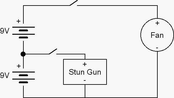

I'm running my chamber fan on 18v (2 9v in series) and I would like to someday add a stungun to my cannon. I also want to try to run both the fan and stungun off just the two batteries. But 18v will damage the stungun right?

A 9V stungun will probably fry itself at 18V
Simple solution, take a voltage tap between the two 9V batteries. Use the 9V for the stungun and the 18V for the fan.
Two 9V batteries to power a fan at 18V and a stungun at 9V.

jimmy... thanks. I didn't even think of that. :oops:

I appreciate the advice, but jimmy's idea is simplae, and I love simple.

Yeah I'll be going with jimmy's idea, its better for my application anyway
