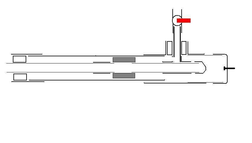

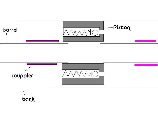

I am in to pneumatic spudding (I have produced three cannons) and recently had an idea for a new kind of piston.
As opposed to sealing against the end of the barrel the end of the barrel is capped off and a piston (The piston is shown in grey) slides around the outside.
When the piston is forward it covers a few large holes ( A bit like a breech) put when it is piloted it slides back opening them
Two (or three or four etc.) home-grown one way valves ( The valves are similar to the one in Ant's simple airgun) are installed in the Piston itself.
They are simply mildly strong springs pushing a ball bearing against a bit of rubber to seal them.These might be unnecessary ( You could get away with just small holes) but will improve effiancy
The second diagram shows a gun using the piston, and is relatively simple once the above is understood. The only things that need to be noted are
- The barrel passes through the tee which only supports it.
- The the tee and the pipe leading to the valve has holes in it so when the valve is opened air is released
I am posting to share the idea and to ask if the extra expense (This requires O-rings and a lathe) counters any improvement in power.
P.S. If anyone spots any problems with the design let me know.
P.P.S. I apologize for my appalling art-work (The computer was giving me trouble) and voracious use of brackets.
-Sorry, Just noticed, there should be a tee were the piece with the valve meets the barrel but the atachment keeps deleting it
This is the Piston
This is the Piston
new piston design.JPG (21.82 KiB) Viewed 13487 times
And this is the Cannon using it.
co-ax using new piston.JPG (17.8 KiB) Viewed 13486 times

maybe if you could make a animation it might just clear up a few things, looks pretty resonable from what i can work out, good work keep it up. Welcome to spudfiles.

It's a slide valve inside a coax.
Hard to get it right and make it seal but it will work.
Not more efficient than a regular piston valve, but it opens up possibillities.

that will work but has some extreme amounts of pilot volume

With holes in the barrel large enough to not restrict flow the sealing end of the barrel would be to weak to with stand a decent amount of pressure. Thats if the slide didn't pull the end of the barrel off inside the tee.

Well it may work, but a normal piston will probably more effective.
Your pilot volume is HUGE. And as far as I can see there are no flow improvents. It has no benefits above a normal piston valve.
It wont do any good, but atleast you tried coming something innovative.
And thats always good. :)
Btw, one check valve in the piston will be enough.
