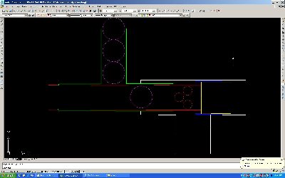

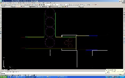

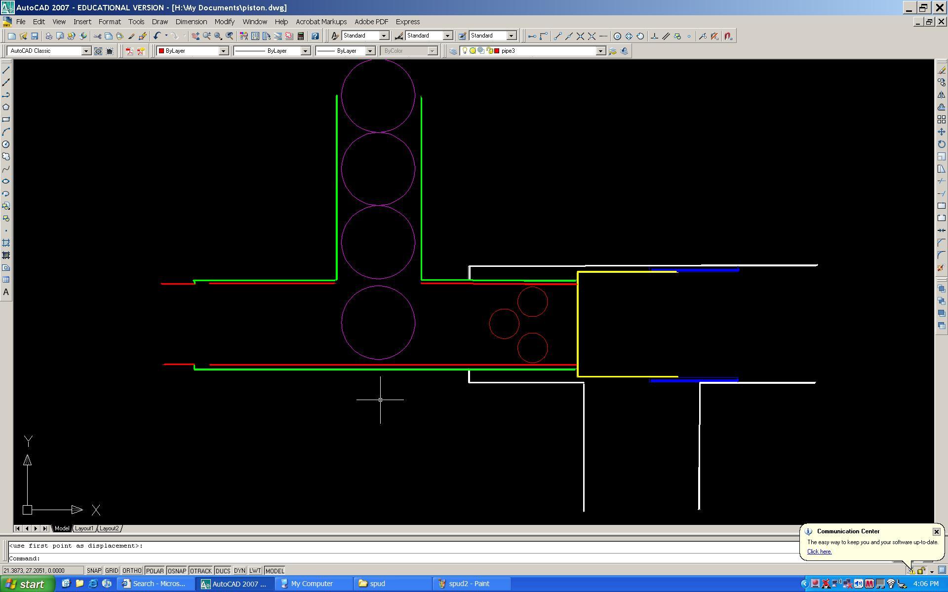

Anyway here is my semi idea.
It's a type of barrel sealing semi auto valve. Instead of having two separate mechanisms to load the projectile and release the pressure, is it possible to combine the two. In the pictures below it shows the bolt directly attached to the piston, but it could be separated by a threaded rod, or other types of connections. Just so long as when the piston pulls back, it takes the bolt with it. Using something like Clide's slider valve on the back http://www.spudfiles.com/forums/semi-auto-t160.html, it might work, just thought I would run it by some other minds.
A few problems that I forsee would be:
-A heavy "piston", takes longer to open.
-Keeping the holes in the bot aligned to allow the ammo to fall through
Just wondering if this has been done before
IMAGE KEY:
white - T housing
Blue - Extra pipe for the piston to slide in
Yellow - Piston
Red - Barrel/bolt
Green - Barrel housing/ magazine
Click on the image to get a better picture, sorry they are so bad. Wish I could do those nice animations, but oh well. Ask if its confusing.
When the gun is pressurized, the chamber being at the bottom of the T.
After the pilot volume has been released and the piston goes back, taking the bolt with it.

woops yep somebody beat me too it. I guess the only difference is mine moves just a small section of the barrel "the bolt" instead of the entire thing.
looks like he didn't get very good performance off of it anyway.

there is someone else who did this with copper pipe and marbles that worked extremely well....
if i could find it id post it here, all i remember is the poor guy who made it was flamed out the wazoo for the fact his pipe looked like it had been burned.
FordGtMan
Posts: 314
Joined: Thu Oct 25, 2007 9:15 pm
Location: southlake Tx
I believe that was the work of copperboy.
http://www.spudfiles.com/forums/viewtop ... tml#113341

mexthatcan wrote:looks like he didn't get very good performance off of it anyway.
In his defence, it is a bit of a work in progress, and had some design flaws such as a small diameter piston. If you feel you can do better we'd love to see your work ;)

Oh, I'm deeply moved by the fact you guys remembered my (I admit :wink: ) rather unsexy canon :P
I'm afraid I haven't posted anything in a while, but I can assure you, I watch almost every thread! I currently working on a "European" version of Clides amazing GB canon.
Yeah, this mechanism really rocks, reliable and simple. Only problem I had was making an air-tight seal at the magazine junction.. The opening time in my canon was quite good, if the marbles wasn't lined up properly, the bolt would easily shop 'em in half. But as in my original post I give much credit to Galfisk (I think Clide played a part too) in designing this type of "linked piston bolt" design a time back.. At least thats were I got my inspiration from.
Anyway Mexthatcan it will be very interesting to see your results! :P
