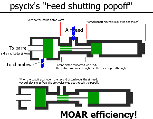

QEV + popoff systems are nice due to their simplicity, but the big inefficiency in these designs is this:
You feed air to the pilot volume while pilotting.
It is ridiculous and has to be solved.
My solution:
Add a second piston, connected to the main popoff piston via a rod. This second piston has holes drilled through it so that air can pass right through it.
When the popoff pops back, the second piston shuts off the air supply (possibly O-ringed) while still allowing the air from the pilot volume to go through the popoff.
Well JSR, efficient enough nao? :D
Spudfiles steam group, join!
That should work nicely, as long as there's enough air to ensure the pop-off actually pops and not fssssss's :roll:

psycix wrote:QEV + popoff systems are nice due to their simplicity, but the big inefficiency in these designs is this:
My solution:

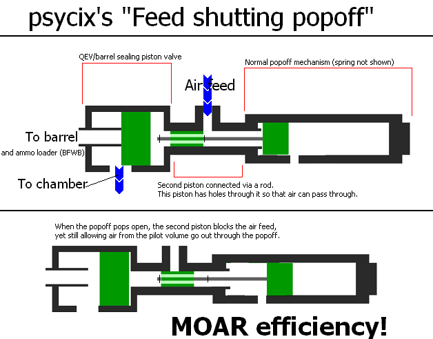

I was looking at your design and have a couple thoughts.
1 Make a custom pop-off. Use a o ring full seal seat. Make the pop off piston with an o ring also. When closed the pressure builds until the piston moves. It keeps moving until it leaks, picking up the big piston, which completes the opening cycle.
2 Put the sealing piston on a sliding rod so the piston doesn't move until after the piston has hit the second step and is well on the way to popping open. This leaves the air supply on until the valve popped.
After the valve popped and the supply piston has shut off the source, the piston will remain closed until the pop-off closes completely. It would prevent sticking at the hiss position. The o rings will need to move with low friction to prevent a stuck valve.
Will this work? Great idea and drawing by the way. :)
Edit, added modified drawing to show proposed changes
Modified pop-off and sliding valve

JSR wrote:That should work nicely, as long as there's enough air to ensure the pop-off actually pops and not fssssss's
One word: TNAK! :D
JSR wrote:Reminds me of the sort of lines we were going along here trying to achieve "pulsing" flow.
I see. Though without changing the piston's effective surface (THE thing of a popoff), that kind of designs tend to go farting, as we learned from your experiments. But the idea of shutting off the air feed is about the same, yes.
Technician1002, I didnt go in detail about the main piston of the popoff / snapvalve because we all know that part. O-rings could indeed be a nice addition, and with the proper hole placement and piston length, allow an air spring to be used.
I would also use a stepped piston that seals via an o-ring instead of a sealing face, as a sealing face starts to leak when the popping pressure is approached.
I think that the sliding rod thing may be unnecessary. It may even cause even more unwanted air loss. I will keep it in mind for future ideas though.
I will probably NOT machine this valve as I have a better idea that is even more efficient... :D
