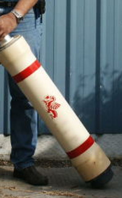

Don't forget with a little heat, PVC expands and softens. Here is an example. Instead of buying a couple 6 inch couplers, I simply swedged the ends of the 6 inch pipe to accept a 6 inch to 4 inch sched 80 reducer for the breech and a 6 inch to 3 inch sched 40 reducer for the muzzle end of this air cannon. You can't buy PVC pipe with a bell on each end.
The finished cannon is a 2.5 inch piston tennis ball cannon. I call it "The Dragon". Both sides of the chamber has the same dragon.
The Dragon tennis ball cannon chamber.

Edit: Tech, wouldn't stretching the pipe like you did reduce the wall thickness and possibly increase the probability of a failure to occur?
