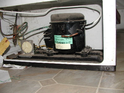

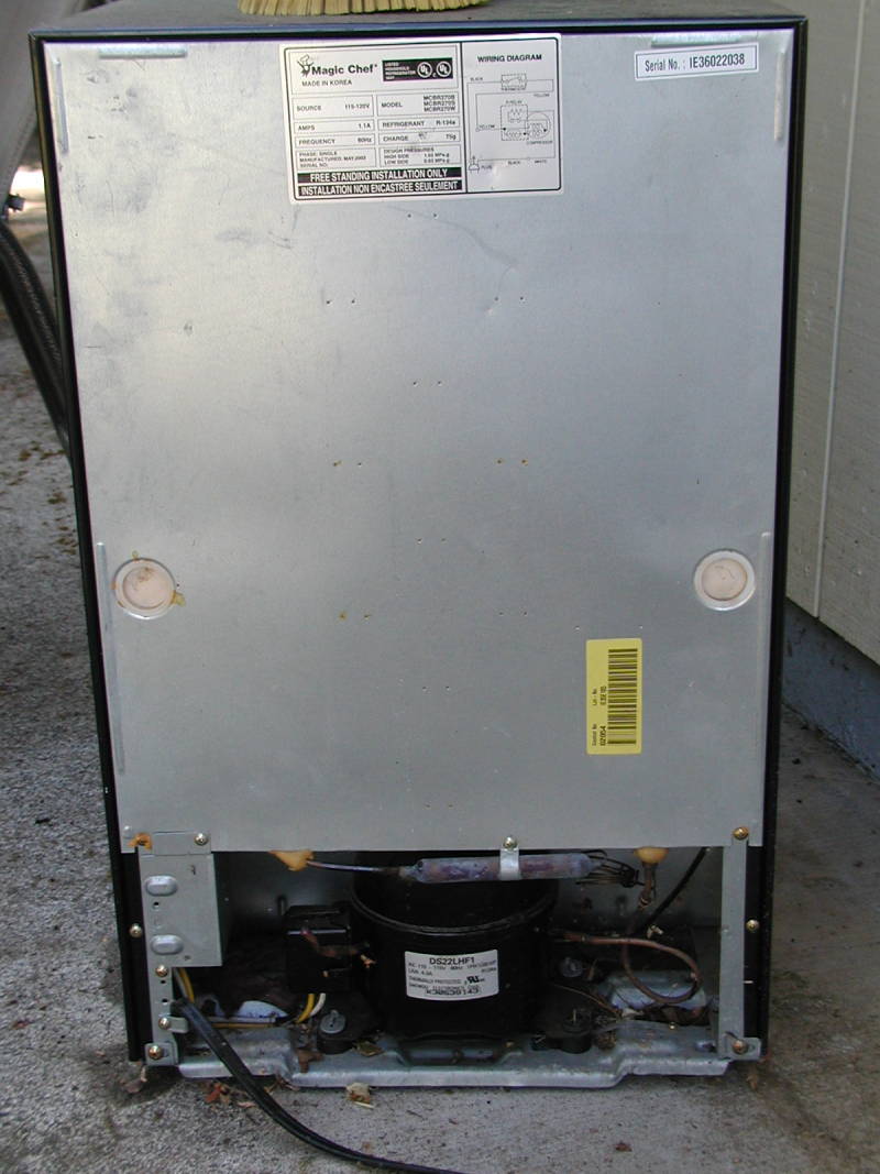

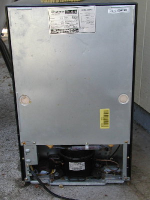

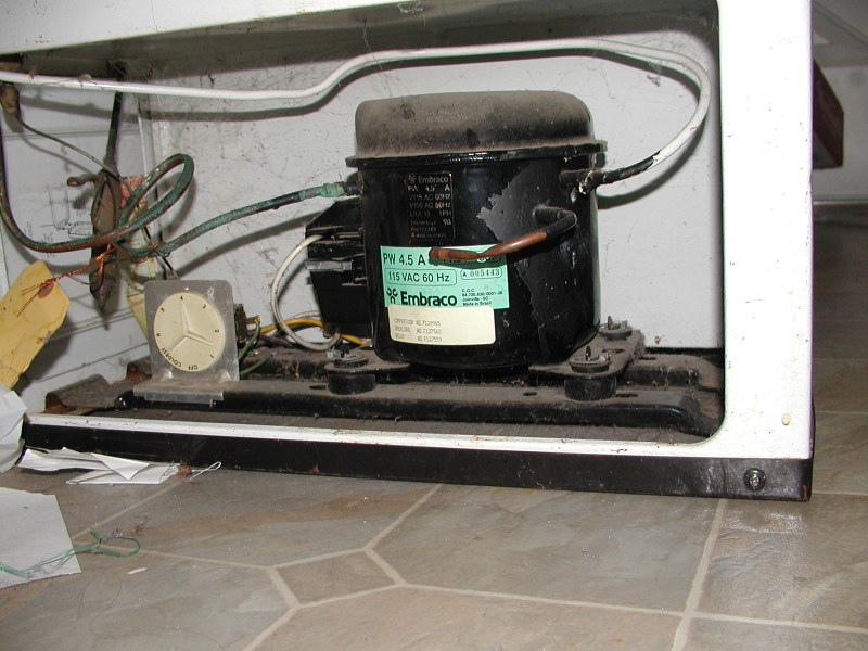

Personaly, I look in the back. If it has a thin cooling tube radiator covering most of the back and a compressor underneath, it has a compressor.frozebyte wrote:How do you see if a fridge has a compressor or not? or can you like hear it?
If it has a Aluminum heatsink and fan, but no tubes, it's thermoelectric.
If it has a tube at the top with fins, a bunch of tubes in the middle at different angles, and a cooling coil below that, and an insulated box that is upright with or without a propane connection, it absorption.
The easiest is look up on Google the model number and see what refrigerant is used. R something is compressor. Ammonia is absorption. None is thermoelectric.
