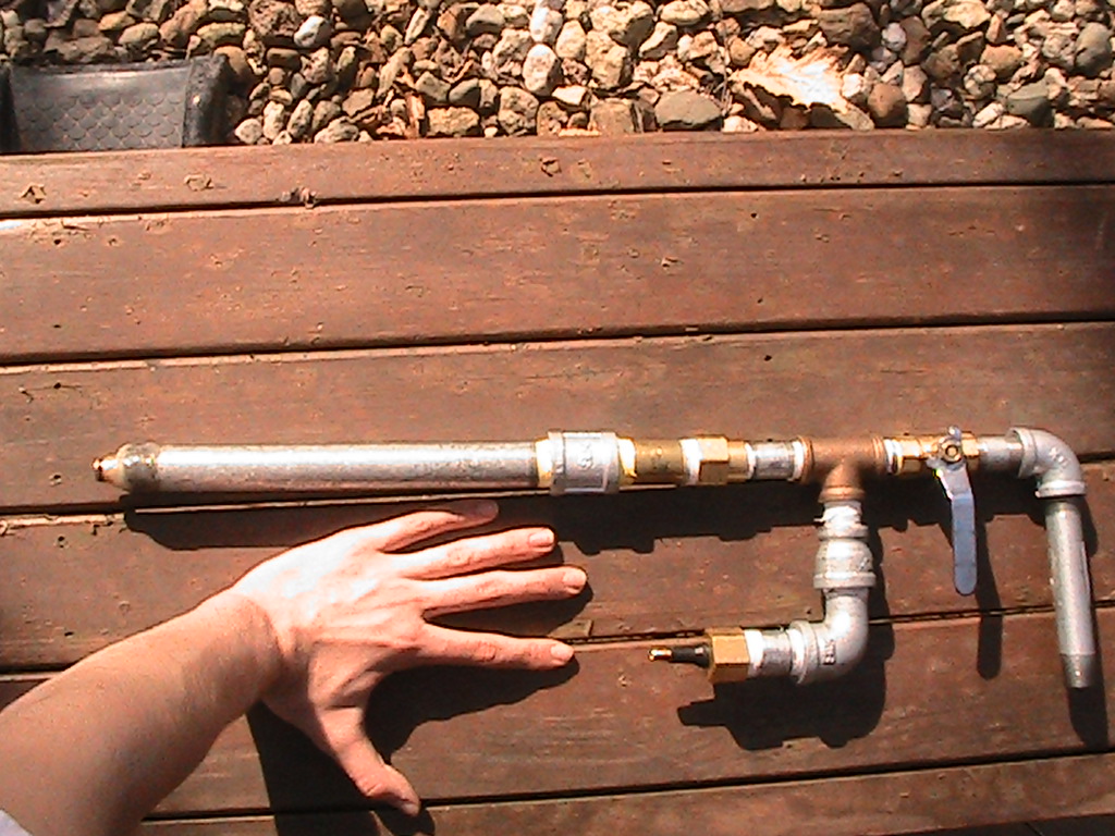

This is made of spare parts after a project with a friend and to be honest i got this idea while doin Geometry homework
the barrel is made from a pressure washer and i filed out the hex at the end.
it has a relativly small air chamber but it works great.
the piston is cast of hot glue and the sealing face of rubber.
it uses vehicle gear lubricant as lube

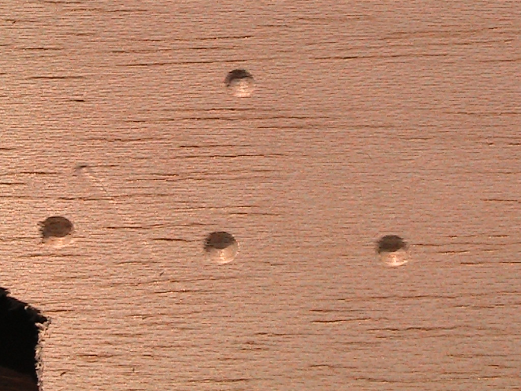

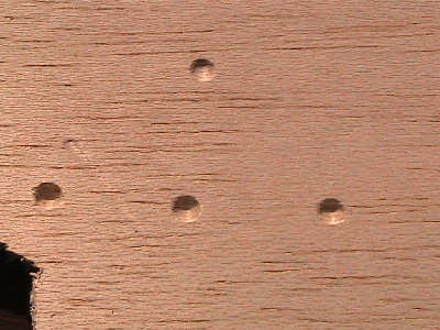

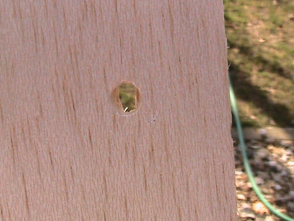

it shoots very strong im not sure how strong but according to damage it seems to shoot stronger then my airsoft dragunov which shoots 520 fps with .20s.
using this air rifle i can shoot through the bottom and top of a soda can with a .20
