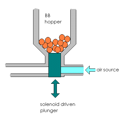

Sounds interesting, photos/videos of it in action? Something like this from what I gathered from your description?
- Is this what your prototype looks like?
- solenoidBBMG.GIF (4.62 KiB) Viewed 5824 times
- with a timing circuit, you could make a select fire automatic ;)

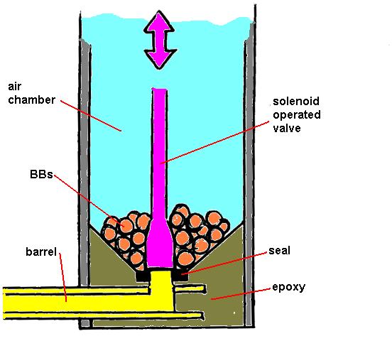

- an idea I had a while back involving BBs and a solenoid, never built it though
- bbmg.JPG (34.44 KiB) Viewed 5824 times
All due homage to Yoda, he replies with graphics that are perfect. I am a long time lurker and admirer of the master, and yes, you got it right first time.
I have made the prototype from HDPE and not yet fitted the plunger; just doing a hand loaded 3 round feed into the top of the block. I will post some photo's / video tomorrow as it stands.

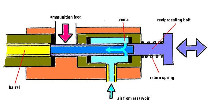

Since you have the facility of a solenoid and preceisely manufactured parts, might I suggest you refine the design a bit more? As air goes into the hopper, some pressure is being lost due to expansion. Why not consider some sort of reciprocating bolt that blocks off the hopper for every shot?
This is as far as I got with something similar but in the end I wanted an air-only device without resorting to electric assistance.
