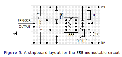

  • A 555 timer used as a trigger for a solenoid
This is my plan, red wine is currently interfering with production this evening but comments welcome.
I propose this circuit to trigger the solenoid, in place of R1 I use a 100kOhm pot to allow for variable time. T= 1.1 x R x C where C is fixed.

The only thing missing from the timer board is a proper driver to drive the gun. The timer is OK for lighting up a couple of LED's and other small indicators, but lacks the current output to directly drive a motor or solonoid.

Technician1002 wrote:The only thing missing from the timer board is a proper driver to drive the gun.
Quite true, Bacchus made me post the wrong picture. The right one has a MOSFET on the output pin plus diodes to protect from the back flow from the coil.
