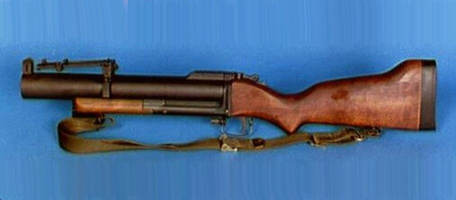

- Replicating this, more or less. the valve would be around the same place as the trigger on this one. The two 1" tanks will be contained in the faux stock, barrel will be the barrel, etc.
- m79.jpg (32.74 KiB) Viewed 3620 times

A QEV may work if hidden in the stock.

After looking at it, I now see what you're saying. If the pilot is pointing up, with the QEV backed into the stock, I think I can still make it look like a continuous 1 1/2 barrel.
Goat did it a while back and used a pressure washer handle with unregged CO2. It seemed to work pretty good and made a rather nice piece of work.
http://www.spudfiles.com/forums/goats-mcs-t12488.html
Maybe you can get some ideas from his design. Also, search the forums for his other one. It uses a sprinkler valve, but still has the break barrel thing going on.
Good luck and I'm looking forward to the end result.

A modified sprinkler valve would do the trick.
Smallest cut up blowgun as the trigger.( Saw off everything after the blowgunvalve)
Then use two 45 degree elbows and a capped off pipe to form the stock.
The rest can be done with bondo and sandpaper, some beige paint and a big brush of darker brown to mimic the wood.
Don;t mess with CO2 unless you know what you are doing.Seriously.
I do however suggest you paint the tip of the barrel bright orange to make sure nobody can mistake it for the real thing.
You could get in serious trouble.

Yeah, I saw goat's, those were pretty cool. However, those have handles attached to the bottom, coming down, instead of just an in-stock trigger. I suppose it could work if I turn it sideways, but I'm still working on the basics right now. Thinking that I'm going to get the pipe tomorrow, then get the stock pieces machined this weekend. Thanks for the advice all, updates laters.
