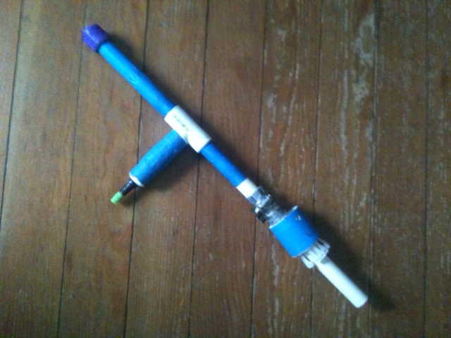

I don't know if this counts as a "pneumatic cannon" but it's pretty darn close. I haven't seen any other bottle rocket launchers on spudfiles (although maybe there are some), so I figured I should post it.
I got the idea from http://www.sciencetoymaker.org. In fact its nearly an exact copy minus the length and male and female adapter.

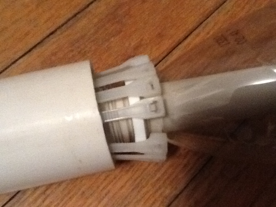

Basically, the bottle is pressed against a rim (made by heating the pvc) and creates a seal. It is held there by having zip-ties lock around the neck of the bottle and a piece of 1.5" sch. 40 pvc is lid up preventing the zipties from pushing out. the zip-ties are held onto the 1/2" "barrel" with hose clamps. More detail and constructing instructions and videos can be found on the website. I have nothing to do with the website. I just thought it would be pretty fun to build and shoot.

How high can you take the pressure before the zip-ties fail?
The design is pretty appealing to me, because there's no need to mod bottle caps to fit the quick-connect fitting.

Nice idea...a homemade zip-tie quick connect...hmm..
I immediately started fantasising about a 12gram CO2 bulb version...
With something to punch a hole bigger than the standard nail..
anyway...back in '87...when I made my handheld bottle-zooka..
I used a steel clamp made from a coathanger...
This is much better.
I could see some simple improvements like having the inner barrel touch the bottom of the bottle.
Another would be to use a pipesize that fits the inner bottleneck as close as possible.( if that isn't the case already)
Also...during my experiments I found that a smaller "jet" gives significantly longer flight time.
Perhaps a bottlecap with a smaller hole could be used with some adaptation to the QD...?
I know I'll have work to do this summer..

I used the quick-disconnect garden coupling as a nozzle for the water rockets, indeed gave a longer flight time

I used a ( heavy) steel QD for pneumatic use.
Worked fine dispite the added weight...

You can't use a bottle cap with this design because then you couldnt put it onto the PVC. And the 1/2" sch. 40 is probably the closest there is. If you put some soap, or even sunblock on it, there's practically no friction while shooting.
And the barrel should be longer. This gun was designed for smaller bottles. I had one for a 2 liter bottle (and boy did it have a recoil) but that one has since been thrown out due to a tragic accident involving a pickup truck in motion, hard tires, and a lot of Broken PVC
