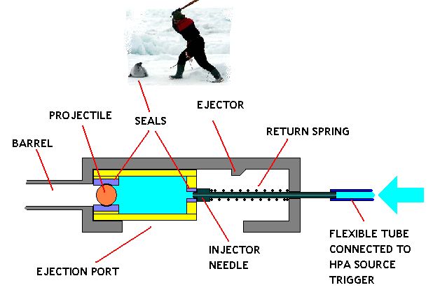

Here's conceptual alternative that might be more practical, the diagram represents the launcher seen from above. The cartridge is a simple tube with a seal on both ends (silicone tubing or similar) with the projectile being retained in the front seal.
The launcher itself has a blowback action, the bolt comprising a spring loaded needle-like tube which fits into the base of cartridge. The trigger is a ball valve or similar, feeding HPA through the injector into the cartridge until enough pressure is reached to "pop" the projectile out of the seal. Since the injector has a very small diameter, it will not take a very hard spring to keep it in place.
When the projectile pops, the rapid overpressure in the breech should be enough to blow the cartridge out, striking the ejector and exiting via the ejection port. This allows a new cartridge to feed from the magazine and so the cycle continues.
The benefits compared do this coaxial design include cheaper and easier construction due to the lack of internal barrel and filling valve, which also means lower weight as well as over 200% of the coaxial's internal volume for the same external dimensions. All of these factors give the design a much better chance of functioning effectively as a true blowback semi/auto design.

hey you have a picture of me :lol: , but anyway.... the design looks good, it will just need to be really precise if you make it exactly like that, i would put a cone shaped seal on the back of the cartridge to insure it lines up correctly. also, WHERE'S THE EPOXY, IS THAT A BRASS CAP I SEE!?!?

spudtyrrant wrote:I would put a cone shaped seal on the back of the cartridge to ensure that it lines up correctly
That's the idea of the cone-shaped needle tip ;)

It might be less work to put the seal on the needle, rather than the cartridges. This would allow you to use any handgun cartridge after adding the tube to the front to seal the projectile. Simply remove the primer for the back port!
you should probably have a sturdy needle with better support, because when the cartridge hits the ejector, it will want to push the needle off to one side (top in this drawing).
Interesting thought, though it will increase the diameter of the moving part, meaning more force on the needle (Injector needle, it's supposed to be a subtle reference :roll:) and a stronger spring will be needed to keep it in place...
Another option might be to use an actual syringe needle that pierces a rubber cartridge base, but I fear flow might be inadequate and cause too much lag between trigger pull and firing.
With an adequate spring setup, and maybe a weighted injector, the hope is that the cartridge will stop while the injector will continue moving back under its own inertia.

By sturdy, I meant aluminum, steel, SS, something that is not epoxy.

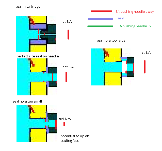

The needle won't necessarily have more surface area exposed to the pressure. The rubber sealed against the outside of the cartridge wouldn't see the pressure. But if you want to double the amount of work required for each cartridge... well don't because I want a brass shower sooner rather than later.

I was thinking of the 2mm O/D 1mm I/D brass tubing I was using for my pico BBMG barrels.

ramses wrote:The needle won't necessarily have more surface area exposed to the pressure. The rubber sealed against the outside of the cartridge wouldn't see the pressure.
How exactly?

Anyway, if you think about it, if the rubber sealing face is doing it's job, it is not subjected to air pressure on the front. That's why we use the OD of a barrel port to calculate the area ratio, part of why floating O-rings actually seal, etc. Basically, if it's sealing, there is no room for the air pressure to push on it. Come to think of it, it may actually reduce the surface area, because if you used a tube in the cartridge to seal it, the front of the wall of the injector needle would be subjected to pressure, but if you sealed the face, you could have only a sliver of rubber
overlap the hole. If the hole in the rubber was too big, you would have more SA exposed.
Forgive me for being a bit thick but I still don't get it, peectures?

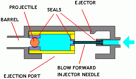

If you wanted to be really air efficient, you could construct a blow-forward bolt with the injector needle as the bolt. By designing the bolt (needle), you could use that as a spring. Spring force would be low when pressure in the cartridge is low, unless the flow restriction is the needle (which is probable).
Food for thought, thanks :)
Edit: potential variation with a blow-forward injector, spring free but probably limited to semi-auto, unless the cartridge develops enough blow-back force to drive the injector back while the the air is still pushing on the piston from the feed side.
I don't think it would eject in semi-auto. the pressure would be gone out the barrel, and the needle would just be dumping .785 mm^2 worth of air out the barrel by way of the cartridge.
Just so you know, the blow forward bolt you drew won't cut off air flow.
pictures soon.
Edit: pictures here.
you may have to zoom in.

ramses wrote:I don't think it would eject in semi-auto.
It should do. It's pretty much exactly a blow-back system.
In fact, I think it would probably eject very violently. If you look, after it starts moving back, the entire frontal area of the cartridge is exposed to pressure, which means there'll actually be more force on the cartridge than the projectile.
It may actually be necessary to add some mass to the injection needle to give it more inertia. Not only to slow the ejection, but also to slow the needle's return (to ensure that the next cartridge has moved into place in time).
Exactly, but then it wouldn't be limited to semi auto. I was saying ( and this was not even stated by me, so I guess I was thinking) that if it was limited to semi auto like he said, it wouldn't cycle. Personally, I think it's work, and I demand videos as soon as it does :D
