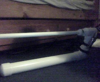

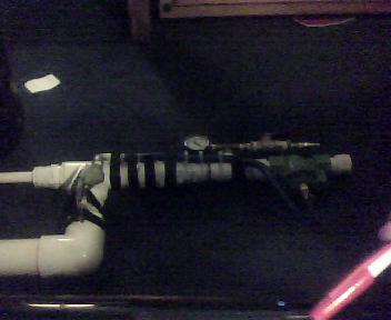

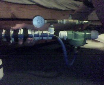

ok so i just finished modding my sprinkler valve to use a blowgun pilot valve. The sprinkler valve is being modded for my new 1.5 inch coaxial piston gun with a piston made from a 1 inch pvc endcap. Anyways the mod went great in my opinion atleast...i mean i think i did a pretty good job tapping new threads for one of my first thread tapping jobs.
But my problem is when i first pressurized my cannon i had few leaks here and there but those were quickly fixed with the addition of more teflon tape...but for some strange reason my sprinkler valve only wants to seal part way and still let a good bit of air leak out of the back...(not where i tapped the new threads those are holding up great)
So from any of you more exsperianced spudders out there any suggestions?
my guess is that its just not enough pressure moving through the valve quick enough to make the seal... but i dont know...i was late when i finally had a chance to pressure test my gun i will run more tests tommorow and give you guys an update
PS this my first post but not first piston cannon...this about my 5th piston cannon...and about my 8th cannon overall... im not a total noob...lets just say i know my way around a hardware stores plumbing section
Any help/suggestion are appreciated thanks!

- the barrel and chamber
- IMG000036.jpg (13.95 KiB) Viewed 4284 times
- the filling valve and pilot valve assembly again
- IMG000035.jpg (14.87 KiB) Viewed 4284 times
- IMG000034.jpg (13.39 KiB) Viewed 4284 times

there might be some dirt on the seat of the valve and its leaking past it, open it up and give it a good clean.
It sounds like you're not filling it fast enough to seat the diaphragm. It looks like you are using a compressor, so you might can try moving the fill valve to the sprinkler valve pilot area.
Also, double check to make sure all leaks are fixed. I've modded a whole bunch of sprinkler valves and I still can't seem to get the threads in the cap straight. Epoxy is liquid duct tape and will be your friend in this. Be sure to check the hose and blowgun valve as well.
How is the equalization hole in the diaphragm? Was it modified any? If you left the little filter on it, it may be hindering the flow, and preventing the pilot area to fill quickly enough.
Check the Hubb Library for The Sprinkler Valve. Lots of good info and has a troubleshooting guide that you might find helpful.
To Hubb,
yes your right i am using a compressor, nothing else on the entire gun is leaking except for the valve, and yes i did pull the little filter in the diaphrams equilization hole out and it still leaked so i put back in and it continued to leak, and i also filled all the holes that needed to be filled with a plastic bonding glue, and it is holding perfectly
