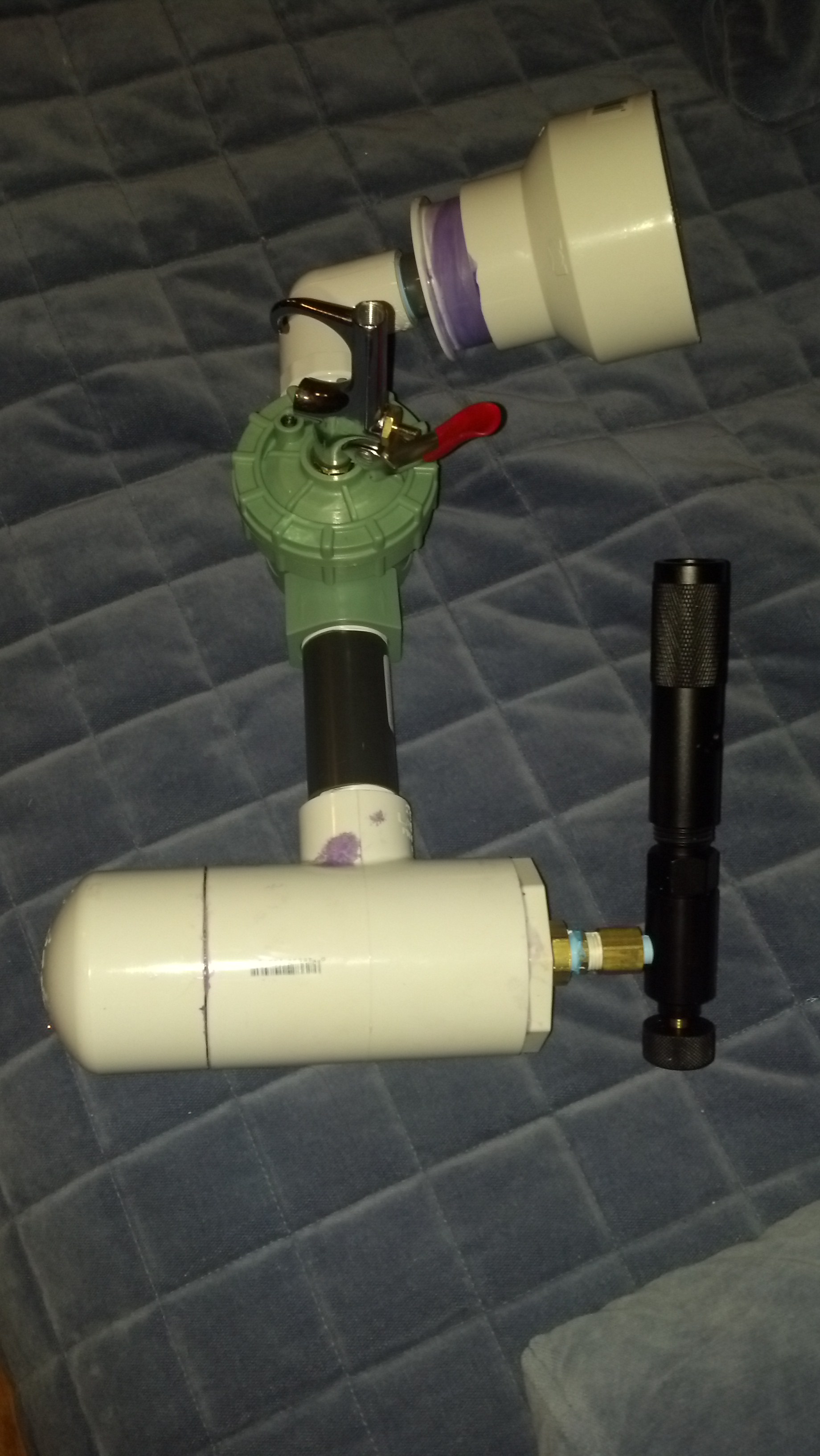

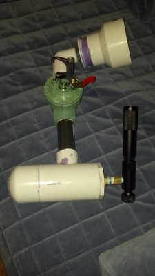

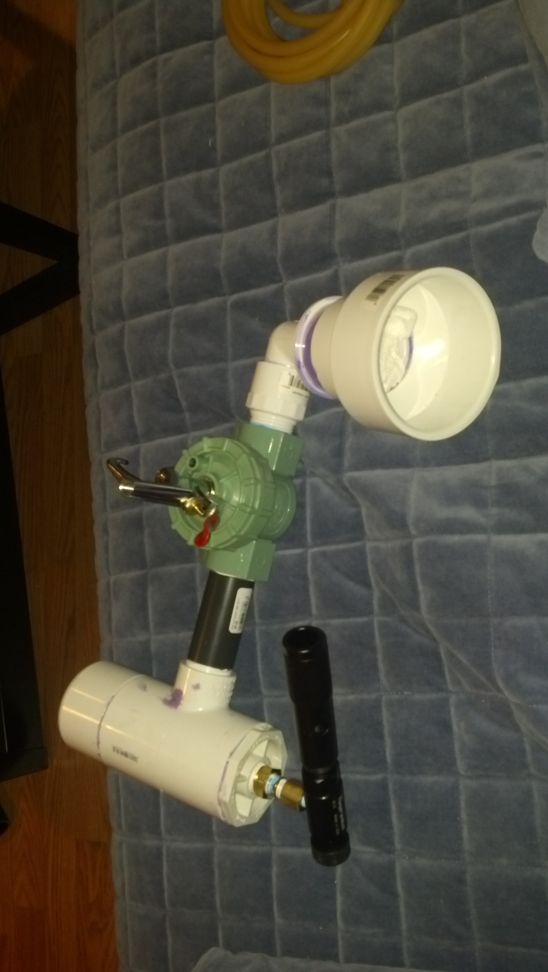

So, it just so happens that I am building this nearly exact thing right now. I have solved MOST of the problems of cost, filling, etc.
I will attach a couple pics of the working prototype. It is a fishing line trip-wire activated Claymore type horizontal firing mine that is filled with one single 12gram CO2 for each shot.
Right now, I am using a paintball 12gram adapter attached to the mine to fill it. The air chamber is designed from 2" PVC schedule 40 that has an operating pressure of 280 PSI. It is designed with a chamber volume calculated to pressurize to about 270 PSI when filled with a single 12 gram cartridge. This is much easier and cheaper for this application than trying to downregulate CO2 tanks or HPA to a defined pressure. The Spinkler valve I am using seems to tolerate that well and it is the Orbit 1" Jar top modified via the nice guide here: http://thehalls-in-bfe.com/GGDT/library ... 1_mod.html
I am going to remove the 12 gram adapter and replace it a Shraeder valve so that I can just fill it using a 12 gram CO2 bike tire inflater like this one: http://www.amazon.com/gp/product/B004UM ... UTF8&psc=1.
Advantages of the claymore type over the vertical firing mine is the ability to use a trip-wire, no need to bury it, and the much greater likelihood of hitting one or more opponents.
It currently works great with liquid paint spray, but I am going to test it out with paintballs soon, which should increase the effective range.
Humancarpentry wrote:So, it just so happens that I am building this nearly exact thing right now. I have solved MOST of the problems of cost, filling, etc.
Looking good! Personally I would have gone for a smaller chamber at higher pressure in the interest of compactness, and used a ball valve as a pilot since it is much more easily activated by tripwire. Using the original solenoid piloting would have allowed for all manner of electronic triggering options, albeit with reduced performance.

That Orbit Watermaster valve is rated to 80psi. You're running it at 270. Can I assume then, than I dont need to worry too much about the pressure ratings on these things? Most of the ones I can find available here in NZ are rated to about 150psi.

Well, in regards to the valve rating, I slowly increased the pressure on it over time while testing it under a thick blanket in case anything were to explode. Hasn't even leaked yet. I think it can probably take more than 270 psi despite the rating, but others on this board would probably have more experience with that. I would not assume safety with anything off the bat. Jack's idea of a higher pressure metal chamber and I am assuming a metal QEV is a good one, probably safer, but likely more expensive.
Jack - the triggering mechanism is not quite finished. I will actually use the airgun as in the pic, but I am adding a heavy rubber band and that will squeeze the trigger when the tripwire pulls out an interposed spacer between the trigger and blowgun handle body. This should make triggering rapid for good valve performance yet still easy to do with the fishing line tripwire. The solenoid would allow for electronic triggering with worse valve performance, but during a paintball game I don't have time to mess with anything complicated or requiring a power source and batteries. Also, with motion detection, there is a major issue with even light wind moving leaves and bushes and causing triggering of the motion sensor.
I also would like to go with a high pressure small chamber, but then I couldn't use the nice $10 Orbit Jar top valve. I'd have to get a QEV or something which I am not experienced in using and would probably cost more $$$.
I am switching to a Schraeder valve and 12 gram CO2 tire filler for ease of filling on the field without extra tools. It allows me to carry one filler, multiple 12 grams and doesn't require me to screw anything on or off the mine. Can be placed and filled in under 30 seconds. Also, I am shortening the dark gray 1" PVC nipple that connects the air chamber to the valve for compactness, and adding a ground stake for stability.
