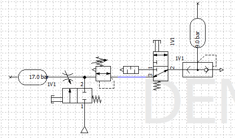

I´ve made a full semi automatic system with DCV and QEV, I have the tank and necesary regulators, my only problem is the barrel. As this is my second gun, I wanted to make it great, so I don't want to be making its own ammo, I rather use common ammo, there is where the problem begins, I can't find any cheap 0.22 or 0.177 barrel and machining it from a steel rod is not an opcion because it will cost over $120. Any good ideas?

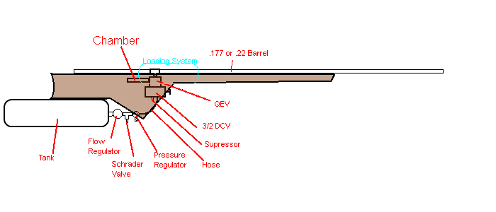

Now, regarding the pictures:
This is more less how I intend it to be when finished

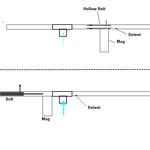

These are the two options I have for the reloading system, I believe they are self explained, I could really use help deciding because it's the first time I'll try a non muzzle load desing.
Grafcet Desing.PNG (13.09 KiB) Viewed 6782 times
This one is a grafcet view of how it works

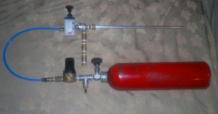

This is the project so far. The "barrel" is attached just for testing purpouses and it's still lacking stock, real barrel, and the trigger which will be instead the 3/2 DCV button.

I like the second design, where the bolt goes through the mag first and then loads the ammo into the Tee where the air comes in.
I've used that before and it works well.
You need just one O-ring to seal the bolt.
I'm not a fan of hollow bolts.
They restrict the airflow and require O-rings in two places to be sealed.

Yes, I believe that the second one is better but I am clueless about how to make either, so any idea on how to make the very bolt? I mean a bolt about 0.18" or 0.23" diameter with an even smaller pin that pushes the pellet further does not sound easy to make, just saying :/
But the coolest part of the second one is that easely once made it can be modified to become part of the air chamber and work as an air cylinder (spring return or air spring return) and make the gun be real semi-auto.
