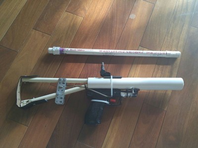

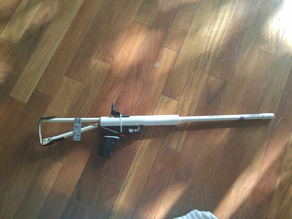

Progress has been made. I finished the cannon this afternoon. Its ready for its first shots. I have an 18 inch barrel of 1/2 inch PVC and a 6 inch 3/4 inner dia. combustion chamber sparked by Char-broil brand BBQ igniter. All of this concealed in a 1 1/4 inch PVC upper receiver and a lower receiver taken from broken Walmart H&K P30 Airsoft pistol. The barrel is threaded onto the chamber because with the stock in place there is no way to access the combustion chamber.
Bravo! Looks good and realistic. Kind of reminds me of the bizon smg. I bet you would take an interest boltsnipers builds http://nerfhaven.com/forums/index.php?showtopic=6183
I suppose the greatest question of all, how does it shoot?

I have yet to find out myself. I was performing testing last night and my igniter began to fail. Less than 40% of my trigger pulls actually generate a spark. I am also having fueling issues. And as for boltsniper, I already took interest in his builds. In fact my next cannon will be partially inspired by one of his pneumatic guns. I simply can't decide on weather or not I want to make it an Airsoft gun. LOL
