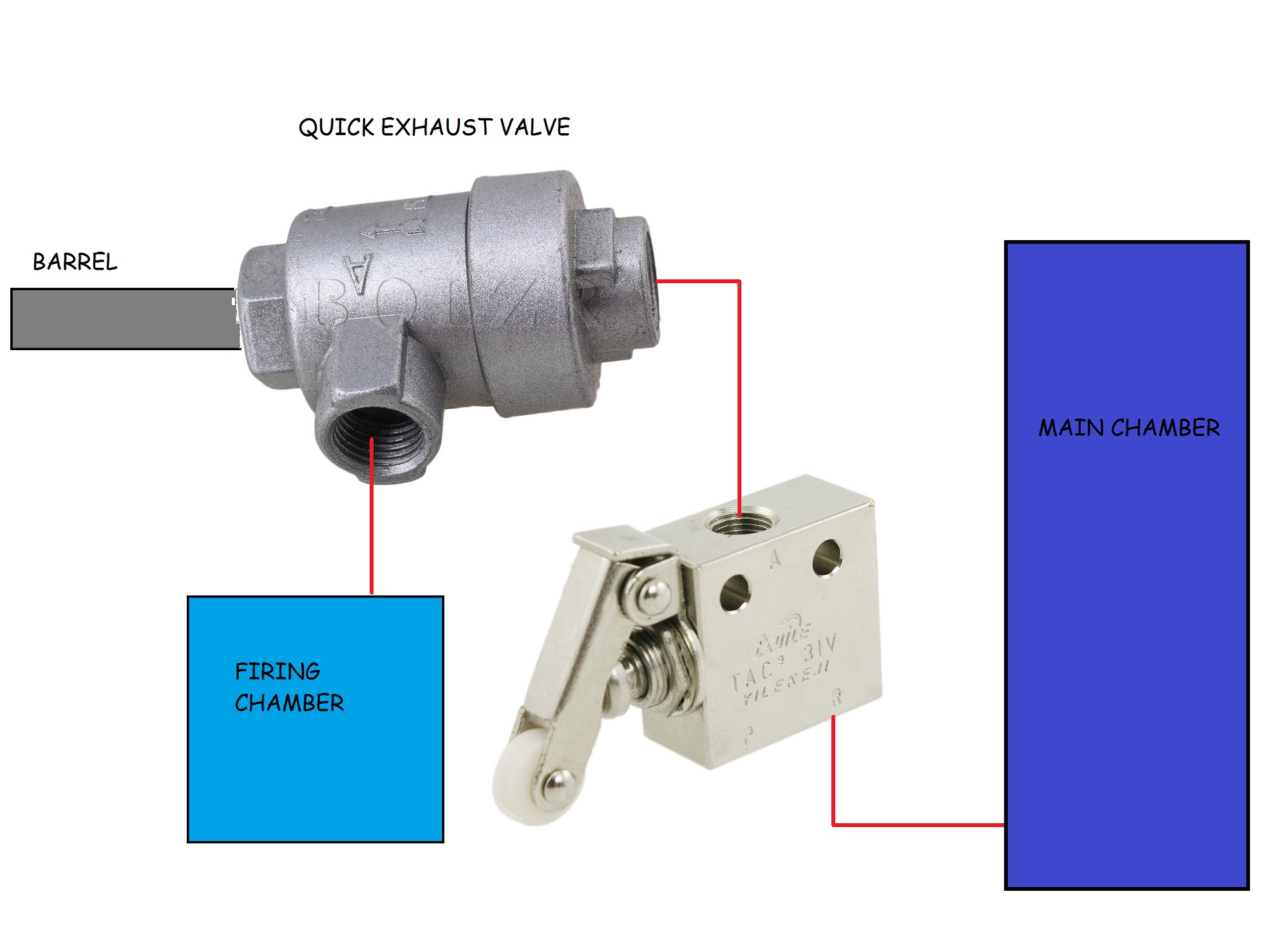

im going to build a cheapish semi auto pneumatic but im not sure what pilot valve will be the most "trigger like". ive looked at solenoids hooked up to a momentary switch but solenoids are sometimes a bit weak. i also have ruled out slide valves but i cant seem to find a mechanical spool valve that isnt overpriced.
please help. (sorry i am a bit of a noob!)

they make nice triggers, specially if you add a trigger like attachmentjackssmirkingrevenge wrote:http://www.ebay.co.uk/itm/Pneumatic-2-P ... Sw7GRZNZkM
could you show me how to set one up in a basic semi-auto configurationjackssmirkingrevenge wrote:http://www.ebay.co.uk/itm/Pneumatic-2-P ... Sw7GRZNZkM

What is that 3 way valve with the lever called?jackssmirkingrevenge wrote:
