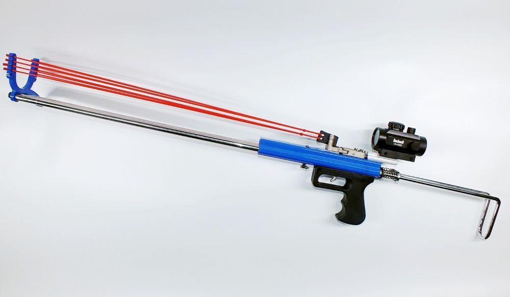

The Airrow Gun comes to mind, it claims "an impressive 475 fps (*using a 50 lb bow at 29 inch draw)" with 0.22" pellets of an unspecified weight.
Not really impressive figures compared to a spring piston rifle, and looking at the setup you can see why - the air has to turn 180 degrees twice before getting to the barrel, with a lot of dead volume.

@Jack: I stumbled across the Airrow as well. That's a good picture of it -- no wonder the muzzle velocity is abysmal! Btw, I also saw that you made a pneumatic crossbow long, long ago!
